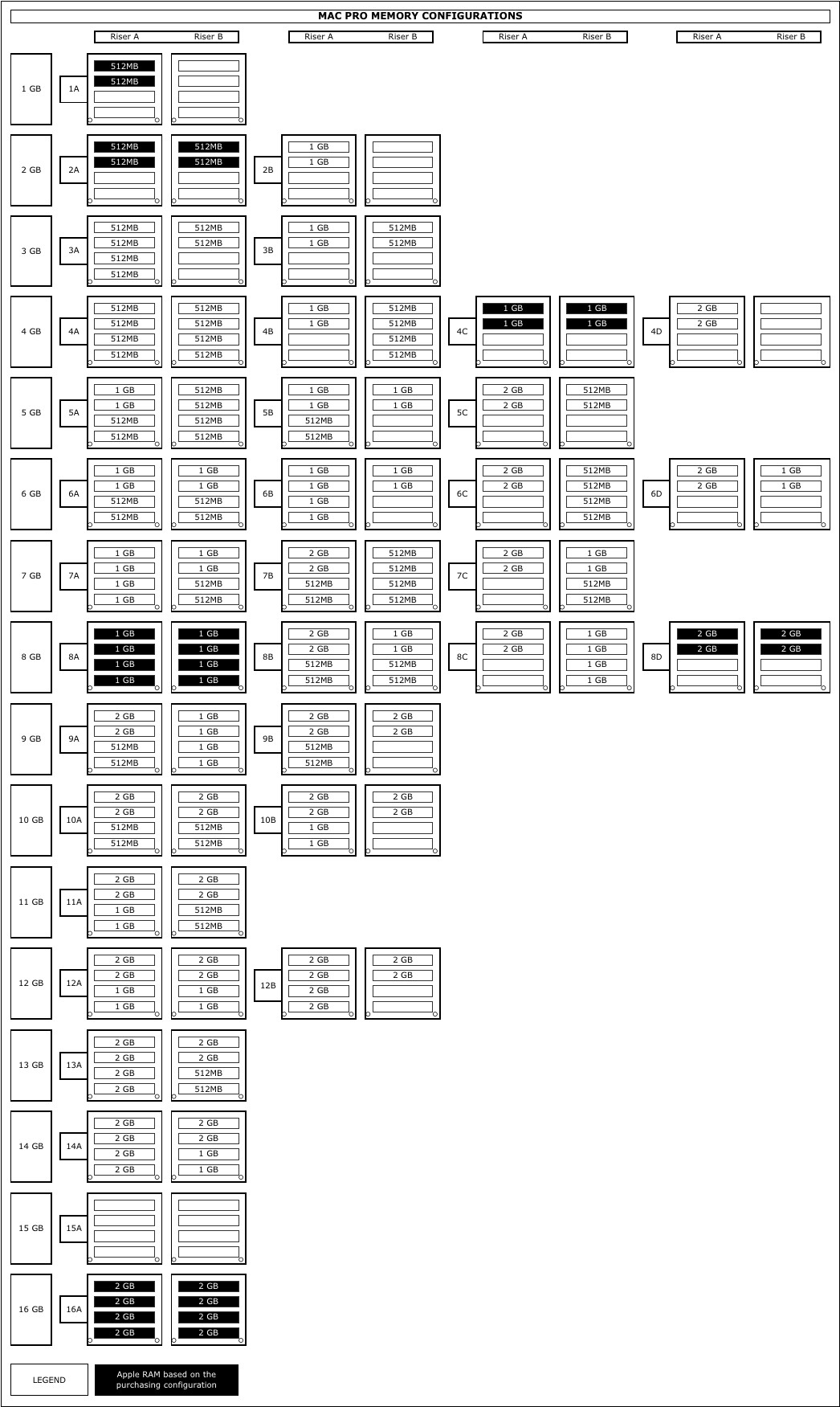

a 3rd vote for bad RAM
After loading some third party RAM, FCP started to crash regularly. It showed up as "Okay" in all tests, other things ran okay, but FCP just didn't like it. I replaced it free from the manufacturer, added some extra and things have been great ever since.
There's a diagram showing what order to load RAM into a MacPro especially if you have certain mixes of sizes, that may help with overall stability.

If anyone has a link to that diagram it would be helpful to some I'm sure. IMO though, since a lot of the programs we use suggest 2GB of RAM, you're smarter to buy in 2GB sets (1x2GB or 2x1GB) and be consistent. If you're doing effects-heavy rendering in AE, Shake, Combustion, etc. and you plan on increasing RAM later, just get 1x2GB sticks as necessary. Stay away from 2GB+1GB or 2x1GB+512MB. Sometimes unevenly matched sticks of RAM can confuse the software, even if your actual amount of RAM is sufficient for the app.

mis matching RAM
there could be an updated version, I've had this one for awhile. My first third party RAM had less than adequate heat sinks. Possibly get the seller to replace free of charge and or give you a refund and buy your own. Most RAM from reputable dealers carry a lifetime warranty.
