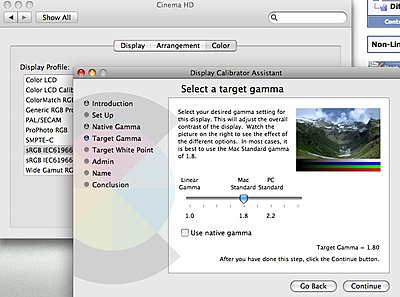

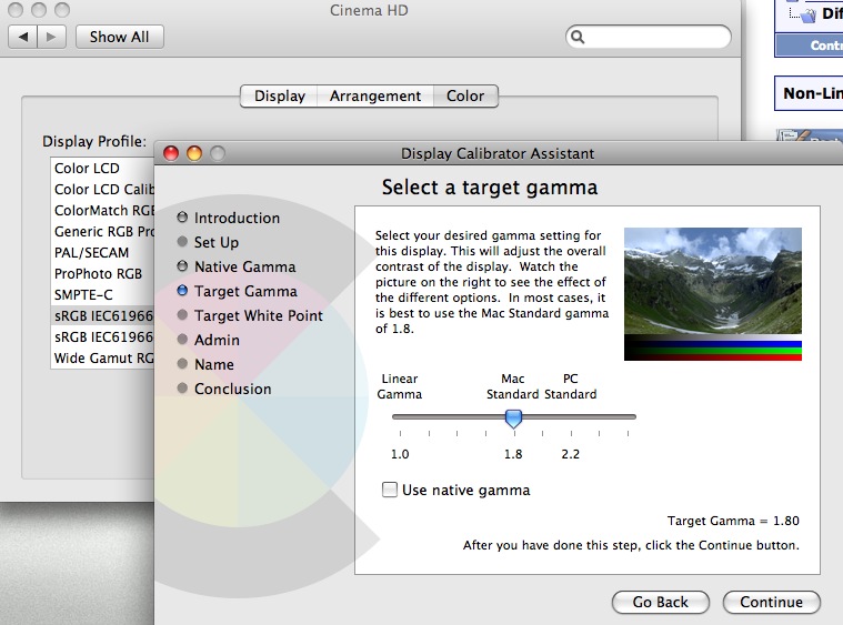

It's very easy; go to your System Preferences and in the Monitors tab calibrate your monitor for PC gamma. Be very careful when customizing your gamma settings; if you're creating an encode for a DVD or authoring and you want to preview how it might look on a TV set "PC" gamma will make things very inaccurate.

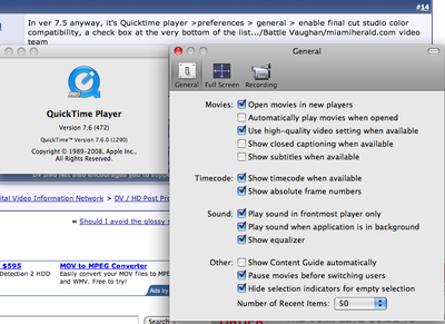

Originally Posted by Nate Haustein View Post
Lots of things could cause this:
• you could have quicktime on the mac displaying FCP color compatibility (option in quicktime)
Nate, where is this QuickTime Option? I can't find it anywhere. I am on 10.5.6 Powermac G5.
Old April 20th, 2009, 02:43 PM   #14
Location: Miami, FL USA
Posts: 1,505
In ver 7.5 anyway, it's Quicktime player >preferences > general > enable final cut studio color compatibility, a check box at the very bottom of the list.../Battle Vaughan/miamiherald.com video team
Battle Vaughan is offline   Reply With Quote
Old April 20th, 2009, 04:40 PM   #15
Location: Boca Raton, FL
Posts: 3,014
Battle...thanks for responding...mine (attached) does not have the FCP item...looks like I need to upgrade to FCS 2. I am on FCS 1. bummer.
Les Wilson is offline   Reply
