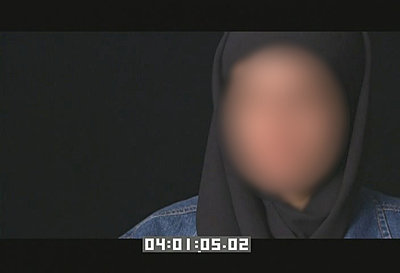

Hey Everybody,
I have 140 hours of interview footage on playable DVDs that need to be converted to:
DV / DVCPRO - NTSC (Highest Quality)
48KHz
29.97 fps
24 bits per pixel (client said this, I'm assuming 8 will suffice)
720x480
Quicktime .MOV
Any suggestions on some good software to rip the DVDs?
Right now I'm using Xilisoft's DVD to MP4 Converter. It allows me to rip the playable DVD to an .AVI file at 2500 Kbps video / 128 Kbps Audio.
Then, in compressor, I convert the .AVI to the DV / DVCPRO - NTSC Quicktime .MOV.
There's one catch, though... all of the playable DVDs have timecode burned into the image!

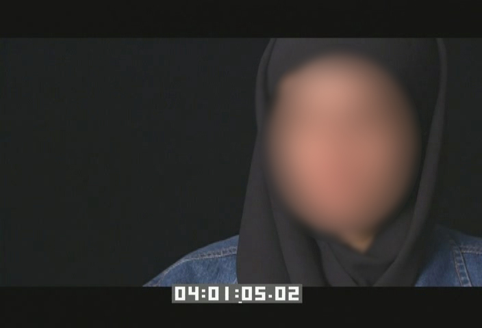

The footage was shot (Anamorphic?) 16:9 DV, so it plays back with a LETTERBOX.
Sometimes the Timecode overlaps the letterbox, so when I convert the footage I need to get rid of the T.C. Burn-in by overlapping it with a NEW, black letterbox.
Does anybody know a workflow using FCS2 or additional software that will help streamline this process?
I've attached a still-image to show how the timecode is burned in, just in case.
Thanks so much!
Sincerely,
John Lofton IV

Hello All,
Well I've determined that using 'MPEG-STREAMCLIP' will help eliminate 1 step in the process ( I think! ).
With MPEG-STREAMCLIP I am able to compress the videos to DV-NTSC directly from the playable DVD.
Does anybody know of any software that allows an 'Overlay & Compress' function?
In other words; I would like to add a pure-black letterbox to ALL of the footage (consistently), as well as compress it to DV-NTSC Quicktime .mov, in a single step, thereby saving loads of time & stress.
Anyone know if such software exists? If not ... anybody want to create it and I'll purchase it? (Just kidding, heheh).
John

I know you can crop the video being exported in MPEG Streamclip. It would make a video 720x400 (or whatever you crop from it) instead of 720x480, but I don't see this being a problem if you were bringing it into an NLE, as black would simply be put in the place of the missing pixels.

Originally Posted by John Lofton IV View Post
I have 140 hours of interview footage on playable DVDs that need to be converted [...] all of the playable DVDs have timecode burned into the image!
Yikes. Are the source tapes not available at all to you? That would be your best source for the material. The footage ripped from the DVDs have already been through at least one heavy compression (to MPEG-2), which means even more will be lost in the next generation -- not to mention those pesky timecode burn-ins.
