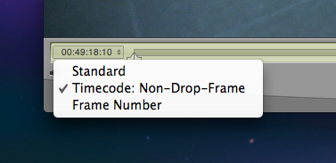

I now just learned an additional alternative that I didn't know existed. I'm shooting XDCAM EX (Sony EX3 camera) but I would assume this works with other cameras as well. Just open any of your clips using Apple's Quicktime Player (I'm using Quicktime Pro) and click on the time at the bottom left. You'll notice that you have the choice of Standard, which is the default time display or Timecode, which is the time code from your clip.
This is a big deal for me because it means that I can just copy my clips to a portable hard drive and as long as my clients have Quicktime (I need to research whether they need QT Pro or not) then can view the clips and easily create a paper log.

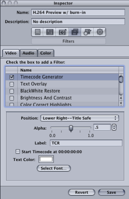

Using Compressor to transcode to smaller files using the H.264 codec, you can enable the Timecode Generator video filter (see attached screenshot) which saves you the step of having to render a filter in FCP and then transcode.
Mike Barber

Wow! Didn't know that either! Thanks a lot Mike. That "might" be the best way to go of all. Depending on render times. Thank you very much.

Sending QT clips using H.264 codec (in compressor, set the Video settings to single-pass, frame rate=current, data rate=automatic, quality=high. In the Geometry tab, set dimensions to either "50% of source". A good option, but will add time to the compression, is to enable the Timecode Generator video filter to burn-in the timecode) is a good idea.
Using the settings I outlined, a 29 minute XDCAM EX clip that is 7.4 GB in size was reduced to 307 MB, as an example.
The time it took for my Mac Pro to render these clips out was prett decent, but I can't remember how long at the moment.

I ended up going another route. Kind of a combination of the recommendations from this thread. (thanks everyone!) Here's what I did.
NOTE: We have the Flip4Mac WMV Studio Pro plug-in for Quicktime as most of our clients use Windows. So being able to email or FTP files in the WMV format is a big help for us.
1) Set up Compressor so that it compresses using one of the Flip4Mac WMV format presets
2) Turn on the Timecode Generator in the Filters Tab. (Thanks Mike!)
3) Submit
It works pretty fast and we can FTP (or even email) to clients/producers for them to review the footage. This is a great new solution for doing window burns.
