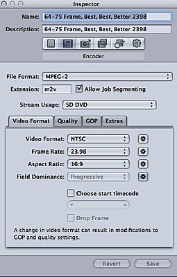

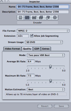

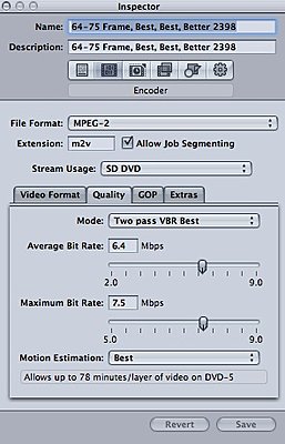

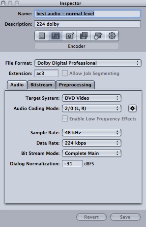

Niels,
Assuming you're using Compressor 3 try these settings for both your video and audio. One exception: "Frame Rate" should be whatever your preferred output source is, it's not required to use the setting here for best results.
Audio should *always* be AC3 Dolby; WAV files take up too much space and don't always encode well into the DVD spec.
DVD Studio Pro video bitrate to high?-picture-1.jpg   DVD Studio Pro video bitrate to high?-picture-2.jpg
