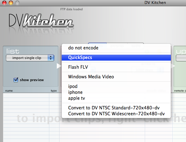

CompressHD works awesome with DV Kitchen, you will need to custom create your own Settings until DVcreators or Matrox bundles them in the install. DVcreators has been working with Matrox behind the scenes on this for awhile now.
I just bought an Elgato turbo.264HD this morning to test. I'll post back my results.

How are you getting to that window Guy?
-C
-C
Hi Chris,
In DV Kitchen press the green "+" for Create New Recipe > QuickTime Movie > Video Settings
Man, this little turbo.264HD so far is pretty amazing for $149. I'm impressed. Although for some reason in Compressor nothing comes up in the Batch Monitor during the encode but the little light is glowing on the USB unit itself. Could anyone else confirm this? In other words, there is not a progress bar at all if I create a setting using the QuickTime components and Submit the batch then check the Batch Monitor. The encode does indeed take place and the finished movie does work, I'd just like to know the status of the encode as it is processing.
