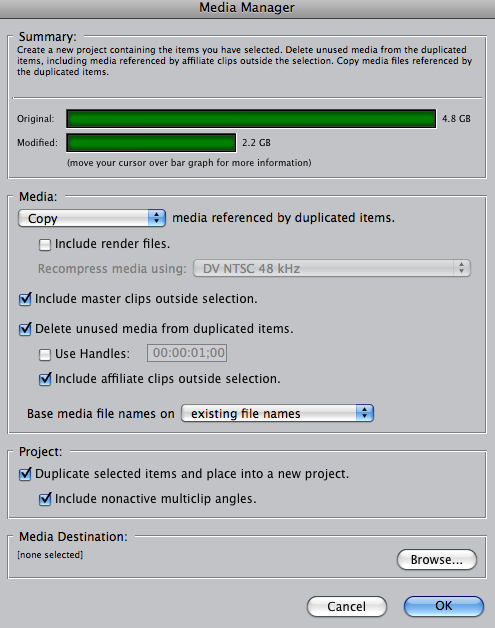

So heres my issue - i'm about 70% through my project and my media management is mess. Worked with one editor, now i'm picking up the tail end and footage is everywhere. Plus all my source footage is on my EXT drive. My friend told me horror stories about a failing drive and he scared me straight. Heres my question:
At this stage of the game how do I not only back up my footage but switch, so all my footage is now edited from my IMAC and not my external. How do I bring over all the files (audio & video) without knowing where they are? (my project is a short movie with tons of source footage) Looked around but haven't found that magical button yet!

Called Media Manager (or Mangler if you use it wrong). Search the forum and check the FCP manual.
It will allow you to copy (with options) every clip in your project to anywhere you choose.

Chris is right that Media Manager can become Mangler very easily--so why don't you just keep your external drive and get another one to back it up every night, using a program like Synchronize ProX or Carbon Copy Cloner or Super Duper. Lot easier (and less risky) than bringing all that media into your Imac. Even if you do bring it all into the imac, you've still got the same problem, i.e., all your media on one drive. It just happens to be your internal drive now. You're still going to need a backup.

But thanks for the tip and now I have a backup of something on my driver, just not sure what it is. Save 2 arbitrary sequences and it only backed up like 1gb (think my project is closer to 80-100gb. All my footage is built in the time line so is there something more specific I can do ?

Thats exactly what I did yesterday - backed up a couple hundred gigs on my USB drive (painfully slow) via the media manger (just like the image provided above). What exactly transferred over ? Was it everything in the timeline. Was it everything in the project ? Was it everything ? I also set up Time machine via that same drive. Does that back up my FCP project as well ?
