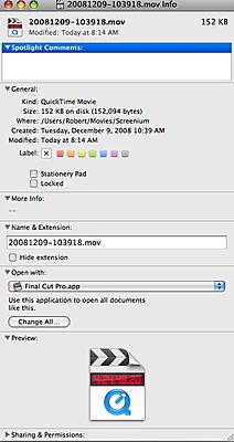

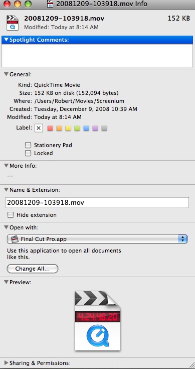

The other issue here is that these recovered files have their resource-forks broken. This is OSX metadata that tells the system what program/s are used to open and modify the files.
It may be a simple matter of manually resetting the resources; do a "Get Info" on any of those recovered files that FCP normally would open. Then in the "Open With" setting select FCP from the list. Make sure you hit the "Change All..." button below. Then try to re-ingest those files into FCP.
Also, make sure the extension at the end of these files is ".mov", not ".txt" or something else that would tell OSX to use a different program other than QT or FCP. One of the issues with deep-file recovery is that the software used to recover the files homogenizes all the data into common file-type values. This usually allows for a greater amount of recovered and uncorrupted data; the downside is exactly this type of behavior, where resource forks and other metadata is wiped out.
This would also be a good time to review your archiving and backup strategies to prevent this happening in the future.
Let us know if this works.
