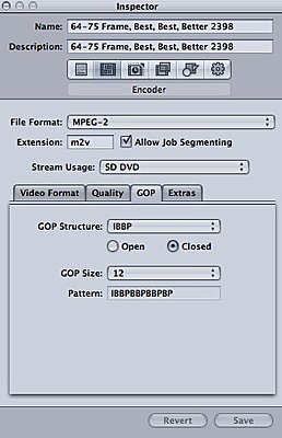

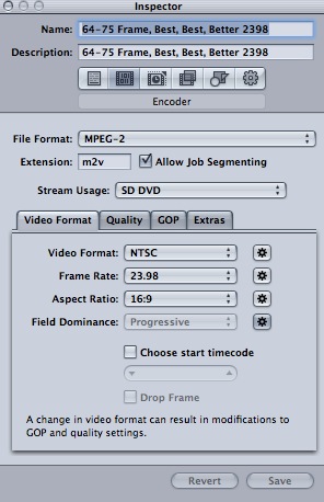

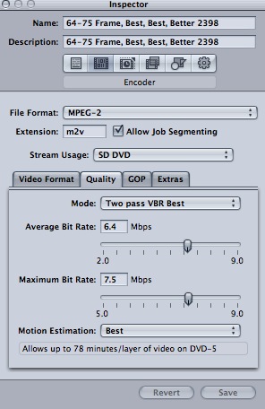

You've got your terminology mixed up a bit; either you're capturing HDV into a ProRes timeline or you're editing in HDV. There isn't an HDV/ProRes setting, it's one or the other.
Either way your capture preset should match your timeline settings, if they don't that might be part of the problem. Or if you've got mixed formats - as you mentioned in a previous thread - you'd still need to convert one of them into the other format.
If you're down-converting HD to SD-DVD don't mess with the GOP structure, there's no reason to do that.

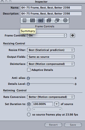

Here's ideal settings to use in Compressor; read the book I recommend: Compressor 3 Quick Reference Guide, Brian Gary... and understand why these work. It will take much longer to do an encode than the built-in preset you're using but the results will be far superior. Use a Frame Rate that best fits your final output intent. If you're converting interlaced into progressive during the encode you may need to tweak the deinterlace settings a bit and see what looks best on your footage. Remember to test small sections at a time, only 5-10 seconds is all that's required to know what you're getting.
I'll send you a bill for doing your home work for you. (laughs)

Tha capture preset is HDV Apple ProRes 422, but I'm not capturing anything -- it's Panny AVCHD SD cards. If I needed to capture a minidv I'd have to use it. The Sequence Preset is Apple ProRes 422 1920x1080 60i 48kHz.
I made some changed per your screenshots, though I kept the Frame Rate at 29.97 since I didn't shoot in 24p.

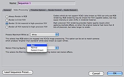

You're still getting your terminology mixed up. There is no capture preset for "HDV ProRes". Maybe you're confusing the "HQ" setting in ProRes?

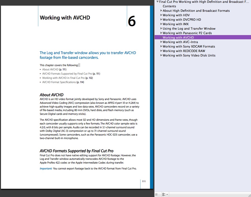

One thing you need to make sure is that since you're transcoding AVCHD into ProRes that you're using the proper sequence settings during edit *before* you send out for encoding to MPEG2. (see screenshots) Make sure you have "Motion Filtering Quality" at "Best".

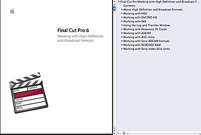

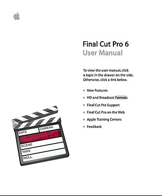

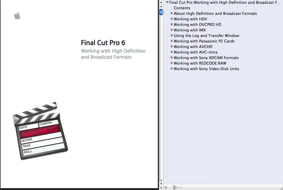

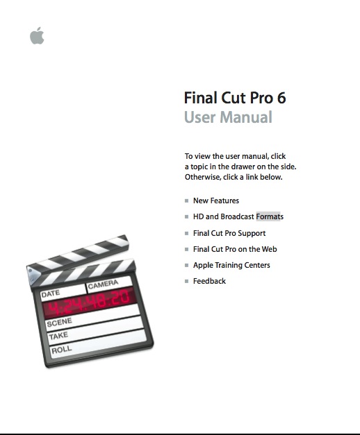

If that's not financially feasible the on-line documentation in FCP and ProRes white-papers on the Apple website clearly outline the proper methods for transcoding, editing and final output. Here's the pages you need to find in your FCP Users Manual; all you need is right there:
Compressor introducing artifacts-picture-2.jpg   Compressor introducing artifacts-picture-3.jpg
Compressor introducing artifacts-picture-4.jpg   Compressor introducing artifacts-picture-5.jpg
