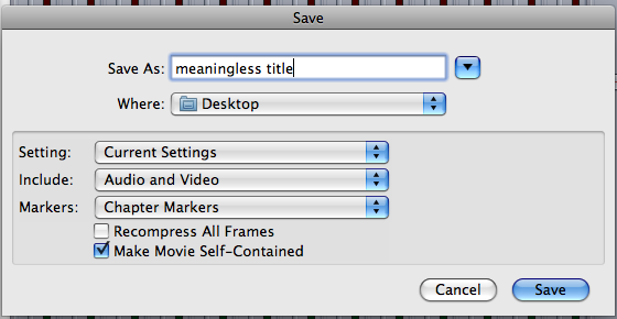

It may be as simple as changing the Setting tab in your export window from "current settings" (as in the picture below) to one of the other options available to achieve compatibility with iMovie.

I question the source of this information because it is not true. Exporting from FCP using the standard Export > Quicktime Movie... option (the first option in your default export menu in FCP) will produce a prompt window such as the one pictured below, the default settings of which will produce a rendered Quicktime compatible video when exported. (Make sure you have checked "Make Movie Self-Contained" if that is your desired option and that you have also included Audio and Video as noted in the "Include" tab.) If you do NOT select "self contained", than your export will be a reference file, smaller in size, but does need to be played back on the same machine ( or drive) from which this reference file can access it's source content (typically the one with FCP on it, and from which it was exported. Making it "self contained" produces a file that can be played back on any compatible and properly Quicktime-enabled machine whether FCP is present or not.
If double-clicking this exported Quicktime movie file on the Mac from which it was exported and on to which FCP is installed, it will likely attempt to open this file in FCP (unless you have otherwise changed your file-type settings to open these in Quicktime) but you can also just right-click on it and select to open it with Quicktime Player or other compatible applications if desired. If settings are correct, this file, when opened on a Mac that does not have FCP installed, should automatically opt to open it via Quicktime Player.

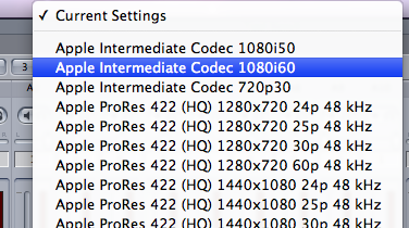

You also might first try to export your file from FCP just as you are doing, but instead of using the default "current settings", change that tab to one of the other iMovie compatible formats that pop up on that list (such as the Apple Intermediate Codec 1080i60 as illustrated below). I presume the resulting file should then drop right into iMovie or FCE with no problem at all.
