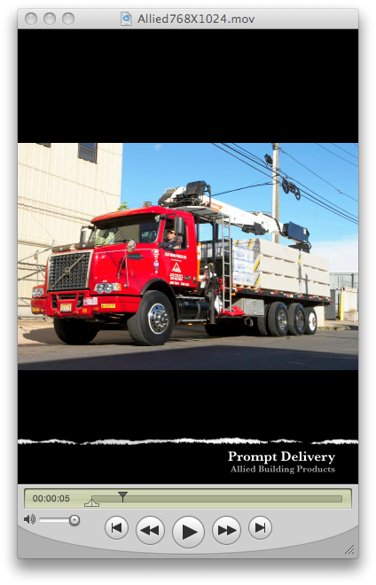

this is a shot of the example video they sent me: 768x1024 H.264 vid. It is already at a vertical aspect ratio (see below). They made it sound like if I gave them a file exactly like this they can play it through their computer through the monitor and it will show up like that (the video card will force the monitor to display vertically?). they can set QT to loop the vid. this would forgo having to flip the video on its side and burn to a dvd so that it will show vertically i take it?? the place where the vid is being shown is in NYC and I'm in Nashville so I have no way of really knowing what the exact setup is...very frustrating. I already edited the vid to match this clip and it looks alright, just letterboxed on top and bottom, but they said that's ok..geez

They are right. You can go into FCP and make a custom sized sequence which will never play on standard video equipment. As long as they are sure that their computer and monitor are setup to play a file of these dimensions then give them what they ask for.

Whoa, that sounds crazy William...that's the thing, I'm just hoping the AV guys at the facility have it under control...I'm sure they do, I wasn't really able to interface with them directly, I've been going through my client and the details on this aspect have been meager at best, but I set up and output my sequence at the said dimensions that the people in NY specified so I figure it's all good...it's like dealing with a middle man
I'm figuring that the video card they have supports a vertical display and they'll just play the QT file full screen and enable looping...In a perfect world the video and images would have all been SHOT in portrait mode and I could have edited as such...but I was just dealing with the material I was given..it was a very last minute project to begin with...should work out hopefully!
