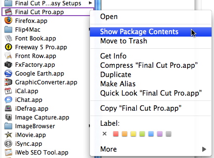

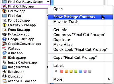

Here's how to find and copy the manuals - the process is the same for each application:
- Goto the FCS app file you want the manual for and option-click to open the options menu (or use the left mouse button) and click on "Show Package Contents" (see pic).

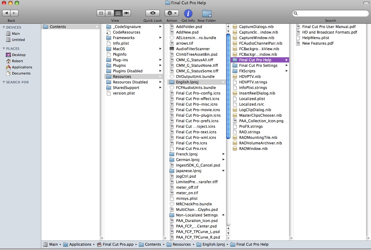

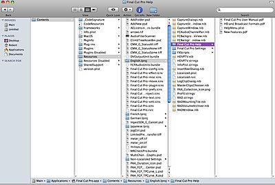

- Follow the path as shown in the second enclosed pic where you'll find the "Help" folder (the name duplicates the app you're searching for).
For example, FCP has 3 separate PDF's that make up the User Manual, Final Cut Pro User Manual, HD and Broadcast Formats, and New Features. Copy those 3 items to a place you can access them anytime.
