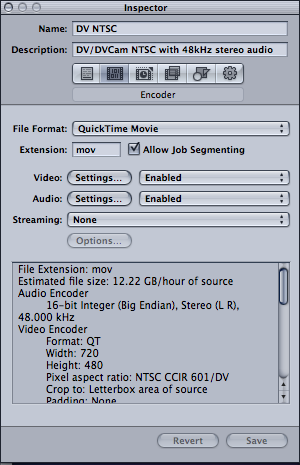

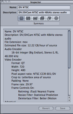

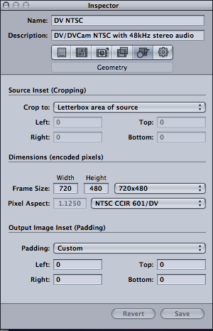

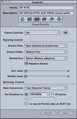

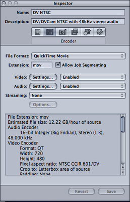

Well I guess I can't post the setting as an attachment. This website won't allow it due to the unique format of a Compressor Setting file. So here are screenshots of the various Inspector pages for the Compressor settings I use to go from 30p HD to 60i DV codec.
NOTE: DV codec is one of the worst quality standard definition codecs. I would recommend using ProRes instead. But the local broadcasters in my area want 30-second commercials delivered in DV codec so that's what I have to give them. (I'd rather send in H.264 - it looks better and is much smaller file size)
