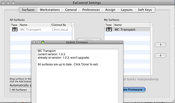

Firmware Nightmare
Ron, Can you verify your firmware version for your Transport?
It won't let me update past 1.0.3 which is incompatible with FCP 7 & Jog/Shuttle.
Hi Christopher:
I will indeed check the firmware version for you when I get back into the video editing suite later on today.
I am certain that you are already aware, but if not, the MC Tranport's extreme left soft button must be depressed for the Jog/Shuttle to work in FCP 7, STP or Logic 9.
Ron Wilk is offline   Reply With Quote

Hello Christopher;
The firmware for the MC Transport is 1.0.3.
I neglected to mention one very important point in re FCP 7 and the MC Transport or MC Control, and that relates to the fact that in order for the Jog/Shuttle of either of these devices to function the MIXER WINDOW for FCP 7 must be open. It can be minimized but it must be open!
If you've done all that and have latched the leftmost soft button on the Transport and it still does not work, then I would call Euphonix support. They are available on weekends and have been very accommodating.
P.S. the above assumes that you have installed the latest software, 2.0.3.6... from the Euphonix web site.

Originally Posted by Ron Wilk View Post
Hello Christopher;
Ron- You've really helped me. I was on the phone with Euphonix support for two hours yesterday. The tech told me that the reason my transport wasn't working with FCP was because of my firmware version. He claimed on his transport it has 1.1.9 firmware.
Needless to say, after following your advice and opening the mixer, my Transport now can shuttle and jog through the sequence. Although, the timecode doesn't see to be working. It just displays 00:00:00:00 while going through the sequence. Any tricks to get timecode to display?
Thanks for allowing me not to chase my own shadow on my Saturday.
-C

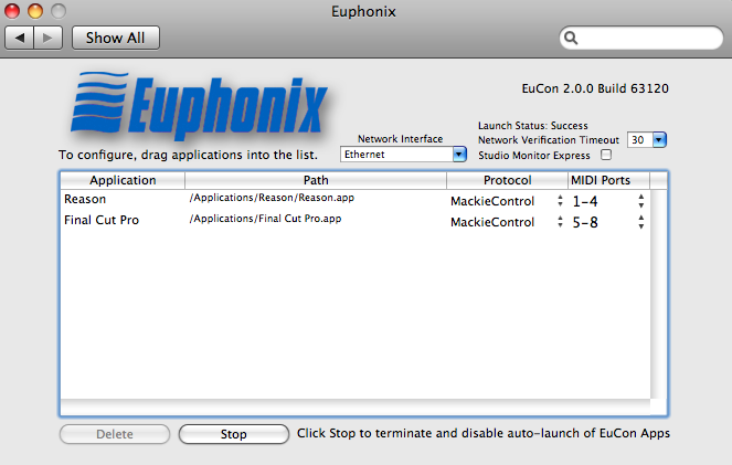

Unfortunately, setting the devices up like you have to in FCP 6.0.6 didn't add timecode in FCP 7. Bummer, looks like we'll have to wait for an update from Euphonix.
I've attached a screenshot to show how I had it set in Euphonix Prefs.
-C
