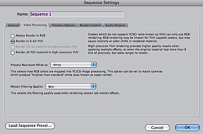

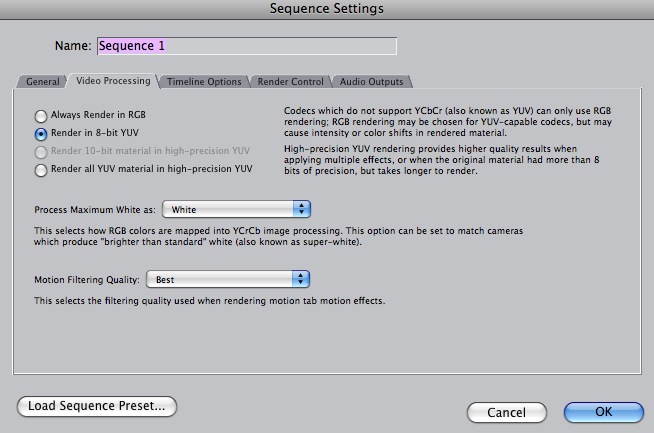

Check your Video Processing settings...
There might be a mismatch between the codec you chose and the render choice selected. It's under the menu selection: Sequence > Sequence Settings > Video Processing tab. Depending on the codec you're using "Always Render in RGB" or "Render in 8-bit YUV" could eliminate the problem. I've left mine in YUV and have had no problems, but that doesn't mean it's the solution.

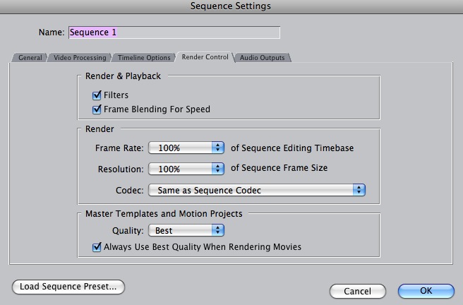

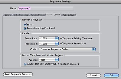

Steve,
Paul's suggestion is spot-on; check your sequence settings. Also, make sure your motion estimation is at "best". This won't have anything to do with the color splash issue but will help all the panning motion be smoother on output. (see pics) Don't try using "high precision YUV", it won't matter for the content/codec you've shot and will only raise render times by a factor of 5x - or more.
A creative suggestion: The vignette filter's edges are too obvious and harsh; it looks like the vid was shot through a tube. Widen and feather-out the filter a bit more then it will look more natural as if it was caused by natural lens vignetting which will add to the nostalgic feel of the clip.
Bizarre phenomenon with fades & transitions...-picture-1.jpg   Bizarre phenomenon with fades & transitions...-picture-2.jpg

Originally Posted by Robert Lane View Post
Steve,
It was already set at 8 bit YUV. Any other possibilities?
