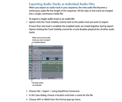

The short answer is FCP can't export each channel like an Avid can.
The longer answer is SoundTrack Pro will do it (has a nice export function that will do what you want).
Although, if you want to stay in FCP just disable the tracks and export each channel separately.
-C

Sharon, FCP is perfectly capable of exporting movie files with multiple audio tracks
Go to your sequence settings and set your Audio Outputs as desired, for 8 tracks of discrete audio then you would set 8 channel. In your sequence you then map your timeline audio tracks to the desired outputs by right clicking on or around each track's track lock (or auto select) button and mapping to the desired audio outputs from the context menu. Finally you simply export your sequence as a Quicktime Movie and that will create the movie with as many audio tracks as are specified for audio outputs.
