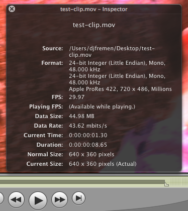

I still don't know what your sequence settings are for your project. What codec are you cutting in (not HDV). This is your problem I think. If you open up your 8.5 GB .mov in QuickTime Player you can determine codec. Just hit Apple+I. Please see the attached screenshot. Everything will be determined in this window having to do with file size.

I could not get to take a snapshot but here is what i have
BCI FINAL.mov
source /volume/g-drive Q /BCI FINAL.mov
format Apple intermediate codec, 1440x1080
(1888x1062),millions
FPS 29.97
Plaing FPS AVAILIBLE WHILE PLAYING
Data size 8.12 GB
Data Rate 120.23 mbits / s
current time 0
duration 0:00:09:40.74
normal size 1920x1080 pixels
current size 1920x1080 pixels
I use the easy set up on the first project and just removed the timeline and added more
I just did not think it would be 8.5 GB for 10 min of any kind of video?
