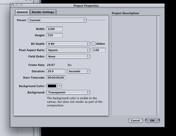

1. When I use Motion, my current workflow is creating with the - "Broadcast 720p" as the project setting. (see attachment) I can then use FCP (and later DVDSP) to just scale/fit into the project.

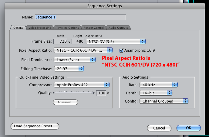

2. When I edit with FCP then, should I set the Sequence Settings to an NTSC DV 3:2 project with 16:9 checked? (see second attachment)? Or am I doing this all wrong?

I think that way would work. But I would recommend editing the whole project in 720p, then in the final step, export from HD 720p to SD DVD anamorphic using Compressor.

I've successfully edited test footage and such with the following workflow/process. Does this still seem acceptable for an SD DVD-output project?
I've decided to edit and finish at 1280x720 so that the client also will have sharp versions if displayed on something like a computer kiosk that can output at HD (unlike SD DVD).
Process/workflow for HD to NTSC SD DVD Project
1. Original Motion Graphics in Apple Motion:
1280x720 @ 29.97fps
Field Order: None
Pixel Aspect Ratio: Square
2. Sent to FCP for editing and exported with the same settings:
1280x720 @ 29.97fps
Field Dominance: None
Then to Compressor 3.5:
DVD "Best Quality 90 minutes" MPEG2 (.m2v, Anamorphic) Preset
Then... imported to DVD SP.. I've adjusted the "Tracks" to be 16:9 Letterbox. It appears to work fine (letterboxed on SD TV and full-frame widescreen on widescreen displays).
Also, I'm sure people have read this before, but for those who havent don't let DVD SP take in your *non-native* (read: non .m2v/MPEG) files. I tried importing a ProRes transcoded export into DVD Studio Pro and the 'converted' footage for DVD was pixellated and downright awful. After some online research, and my own testing, Compressor handled the clip wonderfully and was then brought over to DVDSP in an .m2v format that displayed nicely.
