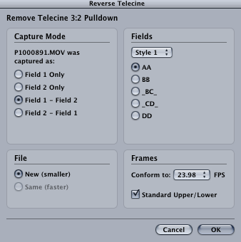

I have a Sony FX1000 with 24pscan
Which is the currect pulldown pattern on Cinema Tools?
Field 1 Only?
Field 2 Only?
Field 1 Field 2
Field 2 Field 1?
And there the styles?
AB
AA
BB
etc...
I'm really lost in this step and I hope someone can point in the right direction. Thank you very much in advance.

This is determined on whether you shot this 24p or 24pA (style 1 or style 2).
The best way of determining pulldown is having After Effects guess it via the interpret footage command. If you don't have AE, simply export a short segment of your clip and run every possible combination. Start with how I have it in this screenshot then move to style 2 after you've tried these five...

I did the Guess Pulldown with After Effects, the guess is:
WSSWW
Excuse my ignorance, how that translate to the Cinema Tools workflow? Which options should I choose in Style 1

What I do is number each pulldown. So, without looking, your number from AE will reflect in CT. So, again, AE will tell you which style (24p or 24pA vs Style 1 or Style 2). Just count from Top to Bottom - they are just different values for the same interpretation.
I don't have AE on this system so I can't number them for you... But stick to top to bottom.

WSSWW should translate to 2:3 pulldown (style 1) starting on BB.
My understanding of AE's pulldown terminology is that the "W" represents whole frames that contain two identical fields and "S" represents frames that are split with fields from different source frames.
So in the 2:3:2:3 pattern you would have
WWSSW if it started on AA
WSSWW if it started on BB
SSWWW if it started on BC
SWWWS if it started on CD
WWWSS if it started on DD
Think of after effects as only showing you the completed frames instead of the fields. It is easier to visualize if you write out the pattern of fields as AABBB (first 2:3) CCDDD (second set of 2:3), then it loops. So in frames it becomes AA BB BC CD DD and then it starts over.
The capture mode should be Field 2 - Field 1 for DV and Field 1 - Field 2 for everything else.
