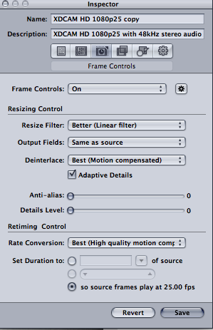

So here's all you need do:
First, make sure your sequence settings for your editing is in the XDCAM 1080p25 preset because that's what you want to be editing in.
Open the Compressor preset for XDCAM 1080p25 and copy that setting so you can make changes. Open the "Frame Controls" tab and turn on the controls.
Because XDCAM 1080-50 is interlaced you'll have to both de-interlace to get to 25p and retime the clips.
Set the Deinterlace to Best, and Rate Conversion to "so source frames play at 25 fps". That's it.
Beware: this will take some time to process so depending on the length and how many clips you have this could take a long time to make the conversions, but it will yield the best results.
Just to note that given the info posted beforehand, it seems likely that the OP's source format is actually XDCAM EX 720p50 ie not 1080 and not interlaced.
Gavin, I think you need to post the specific details of your source before you can expect foolproof advice on this, but assuming it is 720p50 then you can still follow Roberts advice except that you'll have to work a little bit harder ... choose the XDCAM 1080p25 preset in Compressor as before, but then in the Inspector window's Encoder tab you need to click the Video Settings... button and choose Compression Type: XDCAM EX 720p25, then in the Frame Controls tab you can leave the Resizing Controls at default (as these will not be used), but you still enable the Retiming Controls "so source frames play at source". If this is a conversion you might be likely to need again then I'd suggest you also save this as a custom preset.
Hope it helps
