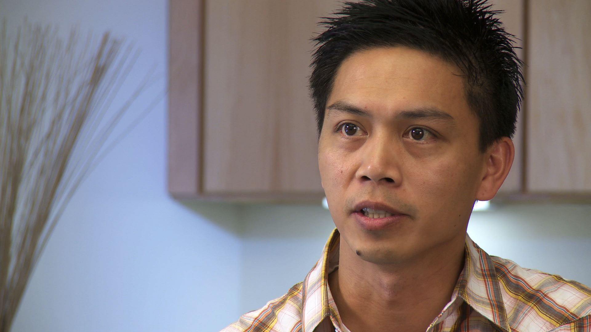

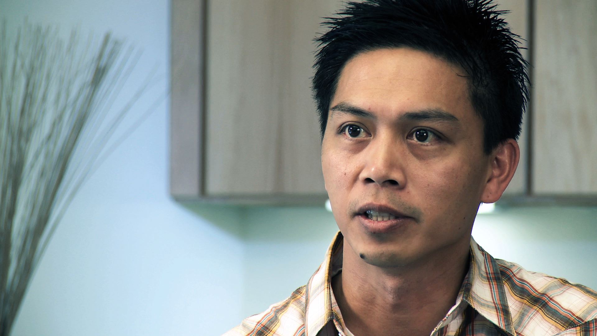

Attached are two grabs from an interview I colored with Mojo - one before and one after. The "before" shot is a little warm but the after shot is ONLY with Mojo applied, although I used an FCP 3-way CC to bring up the gamma just a touch before the Mojo filter - no other CC done at all.
I got this look in about 10 minutes. The great thing about it, in my opinion, is the "show skin overlay" option that highlights what Mojo thinks is the "skin" area - which you can dial in until it's in the right spot (using the "skin color" slider), then adjust squeeze and solo accordingly. It's great because you're sure that the skin tones are in the "right spot" of the color spectrum, which is a very narrow area. Or you can go fiddle with the rest of the mojo settings to get the rest of the shot looking good, then come back to adjust the skin tone independently - good stuff.
That said, the instructions are clear that you have to have a good shot to begin with - you can't really use this plug-in if your shot is not lit properly, blow out, etc. However, you can always do a color pass before using Mojo if you want.
For me Mojo is a $99 plug-in that lets me get a very "expensive" look in a very short period of time - which is worth the money. MB Looks has its place as well, and provides much more fine-grained control, but at the expense of more time spent getting the exact look I want.
I'd suggest grabbing the demo and using it for a while - see what happens. It's fully-functional and just has some red lines across the screen to keep you from using it for real output, but you can fiddle all you want and see how fast you can get results. I did that up until I decided that I had a shot I wanted to use it for, and pulled the trigger.

Magic Bullet Mojo-main-seq-section-5-no-mojo-.jpg   Magic Bullet Mojo-main-seq-section-5-mojo-.jpg

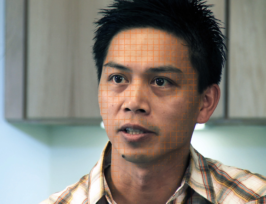

Since I'm already in there, here's another grab with the skin tone overlay turned on. You can see the outlines on the subject's face and neck to show that his skin tone is in the "normal" range for a human (I don't think he's an alien, but sometimes I wonder - I'll check on that next time). I did find that the skin color slider is sensitive and if I went too far the subject's skin went too yellowish one way, too magenta the other - but I got it where I wanted it pretty quickly and am pretty happy with the result. There appears to be a bit of blue tint to the edges of his hair along the line of the skin, and his teeth have a hint of blue as well but with the blue cast across the entire image, that didn't bother me too much...
