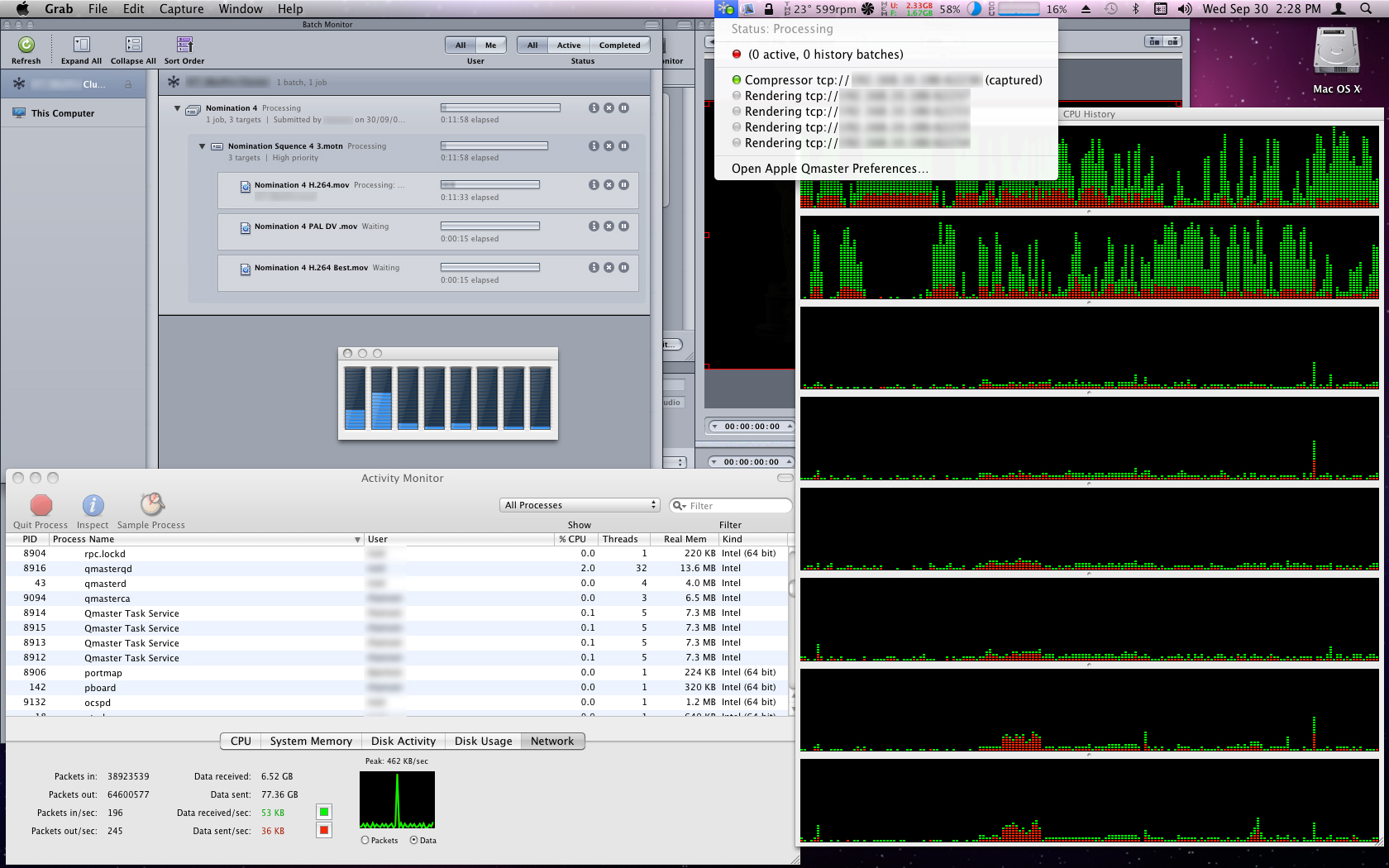

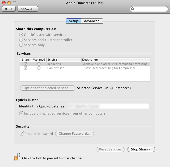

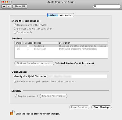

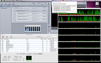

Well, Here we go again, from what I've seen in the world everyone has issues with this sorta stuff and FCS. Im wanting to render some motion graphics throught compressor, and thats fine, but when i send it to my cluster it still only uses 2 cores and not even 100% (averaging maybe 60-70%
I found a number of tutorials for multicore rendering, but I can't get it to work with me.... Here are the details:
MacPro 2.8ghz 8 core (2006 or 7 I think)
4gb Ram
FCS3
OS X 10.6
Separate OS X and Scratch disks
Attached are my screenshots, hopefully someone will know how to fix this, or if I need to upgrade anything - Ram is already on my list of things to do....
While I'm here, every time I open Q-Master in the sys prefs it has to close and open again. Normal? Bug? Just Me?
Ryan
Last edited by Ryan Hansen; September 29th, 2009 at 07:47 PM. Reason: Duh - attachments... :)

Simple fix:
There are 2 issues here, one is the setup:
You've setup your cluster to work as if you're spreading the rendering jobs across a network allowing other computers to share your resources, that's not what you're after. You don't want to *share* you want to *Manage*.
Uncheck Share and check Manage instead, then under "Options for selected service" make sure Compressor is selected in the list above then hit the "options..." button and select up to *half* of the available cores on your machine. Then when you submit your job to Compressor you check the box "include unmanaged services".
BUT, only MPEG-2 encodes will spread across multiple cores, that's because MPEG-2 processing is by default multi-threaded. AVCHD and H.264 are NOT multi-threaded codecs so even with distributed processing turned on you will only use one of your CPU cores, period. Unless someone creates a multi-threaded version of those codecs that behavior will never change. So in fact what you are seeing in your Activity Monitor is correct: the H.264 encodes are only using a single core. There's nothing more you can do in Compressor or Qmaster to speed that up unfortunately.
That is one reason Matrox and BlackMagic have created hardware cards that accelerate H.264 encoding because you can't do it in software. If you're planning on working with H.264 encodes a lot it would probably be beneficial for you to check into the hardware encoding options.
For details on this setup pick up the book from Brian Gary, Compressor 3 Quick Reference Guide.

If you are using Snow Leopard, the QMaster sys pref window will open/close/reopen because that particular system pref is still in 32-bit code!
