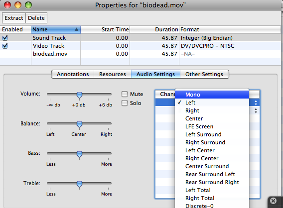

Yes, but not with batch.
Hit Apple+J in QuickTime Pro.
Select audio tracks, re-assign to two mono tracks (see screenshot).
