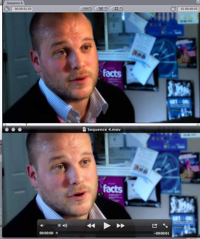

Hi All,
I've noticed recently that FCP is displaying clips a lot darker than the original QT. Or that QT is displaying it a lot lighter.
I've attached a picture showing the same frame in Canvas and QT player.
Why is there such a shift in picture colour/brightness?
What steps should i take to get the colour workflow better in FCP? Is there anything i'm missing?
I'm editing on Apple Cinema Display with no colour correct monitor. I don't need to grade to broadcast standards, but it would be bloomin' nice to know what the hell my picture is going to look like because FCP+QT doesn't seem to know.
Any advice would be great, Thanks in advance.

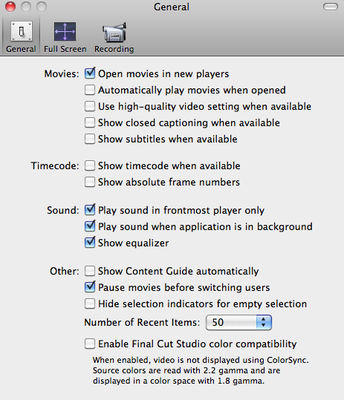

In QT 7 (prior to QT X) there was a check-box for "enable FCS color..." which simply allowed QT to display the same color gamut as FCP does in the viewer/canvas (see pic). However this only affect YOUR machine and did not change the actual output of the file itself. In fact, if you want to view your clip as the rest of the world sees it - especially Windows users - then you'd leave this that box un-checked so you could see your "real" output.
It was assumed that Apple finally addressed this color-bug in FCP 7 and/or Snow Leopard since 10.6 uses the 2.2 gamma setting as it's default however, obviously this bothersome disparity between what FCP displays and the actual color output of the finished file really is hasn't been addressed yet. And it's damned annoying, ain't it?!!
