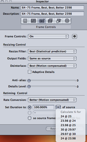

- In Compressor did you force a frame-rate conversion to 30p from 29.97 (see screen-grab)? If so, this is not a DVD-spec compliant format and is the source of your screen-flickering.
Answer these questions and those of us that have time will chime in.
