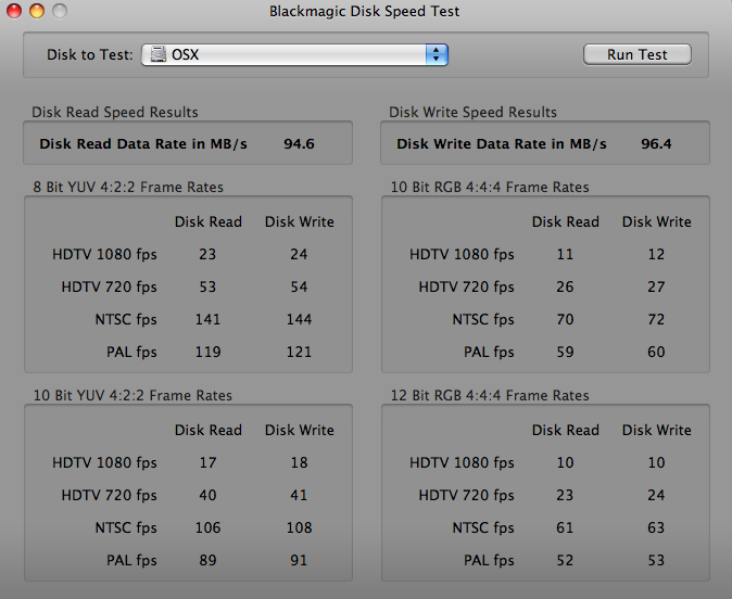

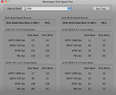

Been using Optibay for about a year...
Here are my speeds. Using 2x 7200 250GB drives in a non-unibody- RAID 0 of course.
Battery life suffers but a huge bump in system performance.
Backup every day via time machine.
-C

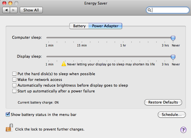

Make sure in System Preferences/Energy Saver that you un-check "..put drives to sleep...", (see screenshot) this should prevent them from spinning down. A quick call with MCE verifies that there's nothing in their kit that would override this setting in Preferences; if your disk is still spinning down/disconnecting after setting up that preference then I'd say there's something goofy with the controller supplied by Powerbookmedic.com.

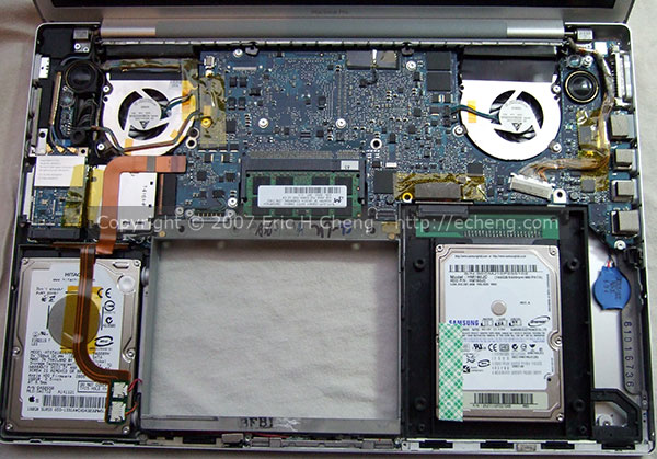

I'll leave you with a quote from Echeng and his blog.
Some folks on the second Digg page are saying that it’s stupid to use RAID 0 in a computer, because there are “no real world benefits” and because it’s too dangerous.
I disagree. My machine is clearly running much faster, and it doesn’t seem to be running that much hotter. The fans still only spin up with high CPU usage. Battery life has always sucked on the Macbook Pro, and the estimates of losing 10-15% seems to be accurate so far. When I copy images onto the machine while in the field, they are simultaneously copied to an external volume for backup. Finally, I back up frequently onto bootable, external media, even when I’m on the road, so losing my internal volume wouldn’t be catastrophic. At home, my system backs up automatically to NAS every night. The only problem is that I would have to work off of an external drive, if the RAID failed. I’d have the same problem even if I wasn’t using RAID.
I used to use a Thinkpad T-series notebook, which was a great machine because it allowed the use of two hard disks at a time in a supported, modular way. I loved that thing.
Anyway, back to the topic at hand. I’d love to hear about the negative Digg commenters’ personal experiences with running RAID 0 in a notebook. I’ll bet none of them have ever done it, and are speaking without any facts to back up their claims.
