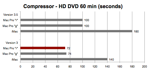

-For reasons that remain a mystery for the moment, the newest version of Final Cut Studio (7) is significanty slower than previous version (6) -- at least where Compressor and Motion are concerned. Hopefully, this will be addressed by Apple's software engineers in a future point release.
Final Cut Studio 6 versus 7

That is curious and I would wonder exactly how the tests were set up. QuickCluster needs to be set up in very specific ways or it behaves badly. Was the recent audio firmware update installed or not? That changed how Compressor worked on my 8-core machine with QuickCluster which I had to reset a different way.
Did they also try renders within FCP? I found those to be faster but not by much. However, I would wait for NAB next month to see if another version of Final Cut Studio is on the way. Whatever you decide, FCP 7 will be faster than FCP5.

There is simply not enough detail explaining how the tests were performed to know whether these results are valid or not. In particular there is no explanation of how someone else could try & confirm these figures.

While there's a lot of detail missing in exactly how the test was setup the results really aren't off the mark. My own testing (beta FCP7) showed the same thing, that Compressor 3.5 was taking just a tick longer to do encodes than the older version.
And that's not totally surprising; FCP had a few more features added to it but nothing was done to improve the core engine that directs things like encodes, renders etc. across the board. It's one of the main reasons I've always suggested to those who have FCS2 to hold off on the upgrade path until the "real" FCS update is released - hopefully this year sometime.
The other thing is that I doubt RobART (owner of BareFeats) setup a virtual cluster. There's almost no need to really do that anymore now that the faster front-side bus is in command and there are so many cores churning away. Besides that, so few people who attempt it even fully understand how to it properly and as W.H. noted, if not done right you're in for trouble.
Until FCS gets it's much needed "full monty" rework internally to take advantage of all the things Snow Leopard has to offer (most notably things like Grand Central Dispatch) you won't see any performance increases from FCS2 to it's current iteration.
The results on BareFeats show Compressor 3.5 taking more than a 'tick' longer than Compressor 3.0. They show it taking around 50% longer (up from 72 seconds to 100 seconds on the Mac Pro). That is why I find it likely that these tests are either wrong because the testing methodology is flawed or don't reflect real life experience.

As I say, I can't offer commentary about how RobART setup his testing - and you should email him directly if you really want to know what he did or didn't do - but again his publicly published tests shore up my own internal testing that in fact C-3.5 is slower in most encoding operations, sometimes it's literally just a tick longer and on other parameters it's significantly longer.
Again the hope is that when the full update to FCS is released that this and the plethora of other most-wanted/must-have improvements are completed by Apple.
