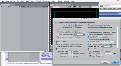

You can change the number of Real Time Audio Tracks as shown in the attached photo from 4 to 20 but I would imagine you'll have playback issues with 20 tracks. The RT AT setting is set as a WARNING and doesn't actually control how many tracks play back seamlessly.
FCP isn't really set up for mixing so 20 tracks is KIND OF a large number of tracks to be working with in FCP. Good luck and let us know.

PS. This dialog is found in User Preferences under the Final Cut Pro menu item.
