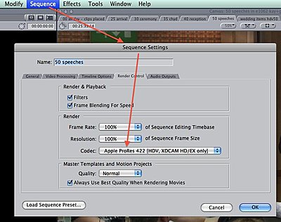

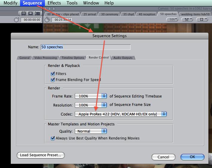

James, as Nigel intimates (and you probably knew anyway): not only create and edit your sequences in ProRes, but also set the render codec to ProRes too:
