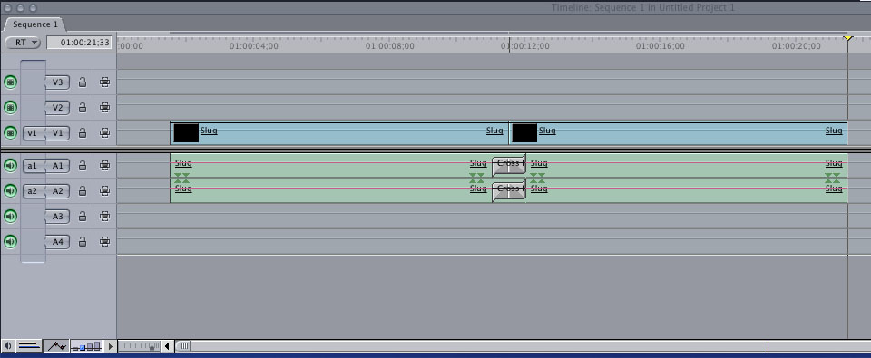

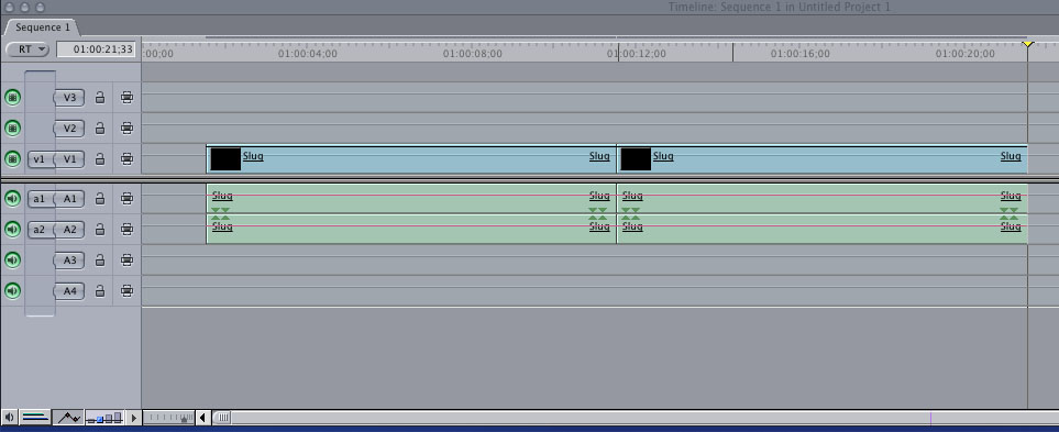

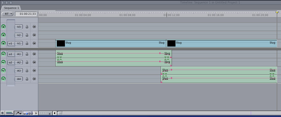

To further explain, see the attached screen captures.
The first shows the first step - two clips back to back - note the cut lines up with both audio & video
The second shows the second step - the application of a 1 second Cross Fade - notice how the marker extends over both sides of the cut, showing the duration of the extensions.
The third is what one would do with the volumes in order to achieve the same effect - notice how both clips extend past the cut.
