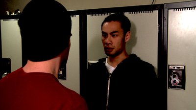

Media imported from 16GB and 8GB SxS cards shot on EX1 in 35Mbps VBR at 1920x1080 at 24P using Log and Transfer after installing Sony's Log & Transfer Utility for FCP v1.0.0 using the Sony crd reader. Never had the camera in my suite so I couldn't check playback.
Files now reside on a FW attached external drive as .movs that have the right file sizes to indicate full size clips and indicate the correct codec and frame size.
The problem is: the images are SERIOUSLY posterized and there is a lot of mosquito noise. This is a favour I'm doing for a friend of mine as his final project for film school and was not on set so I don't KNOW what the incamera footage looked like. He claims they checked playback on set using the camera to feed an HD monitor and it looked good.
What on earth could be wrong? The cards have gone back to the school and we are waiting to find out if they have been reformatted.
I've tried XDCamEX timelines, I've tried ProRes timelines, I've tried XDCamEX timelines with ProRes rendering set up. All looks the same. Source file looks the same in FCP or QuickTime Player.

Hi Shaun - to me that looks like you have ingested proxies, not the Full Res XDCAM EX footage. Are you sure you ingested the full quality of the cards, and I assumed you backed up the entire card to your machine?

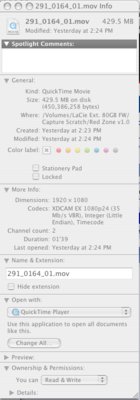

Hi Craig - I thought they looked like proxies as well. I used the Log and Transfer function in FCP to move the files to my Scratch Disk. I've attached the Info from one of the files on my Scratch Disk. The file size looks right at 430MB for a 1m39s clip.
Am I missing something? I used the Log & Transfer, selected all the clips from the card and added them. It took about 15 minutes to transfer 14GB of files over USB2.0 to a FW400 drive. That all seemed pretty normally for full clips - I would have expected proxies to be much smaller and move much quicker.
What part am I missing?

Helps when I add the screen capture...
