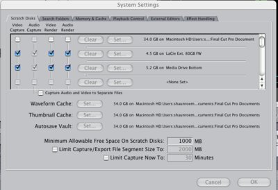

I can't seem to get control over whether FCP captures the video and audio into two separate files or one interleaved file (what I want). The checkbox in system settings to "capture video and audio separately" is OFF, yet FCP seems to want to randomly create both a -a and -v versions of random captures (separate audio and video).
Hi Nils. Unless FCP's dialog box has changed since 6.0.6, there is a check box under the Scratch Disk targets that says "Capture Audio & Video to separate files" - sounds like her system is set with the box checked. See attached screen capture. This dialog is under Final Cut Pro =>System Settings
Hope this helps.
Major intermittent audio capture problems-fcp-dialog.tiff

Thanks shaun, but like I said (even within what you quoted from me), that is and always is unchecked.
This first problem seems to happen mainly when batch capturing previously logged files. Doing capture now, I never have that problem. Sometimes when I select one file and chose batch capture, it then goes on to capture "2 files" and captures the video and the audio separately, which to me is really very bazaar (captures video then goes back and captures audio).
