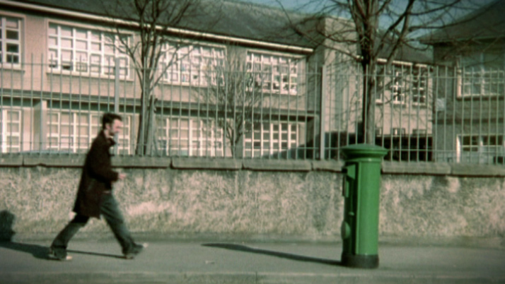

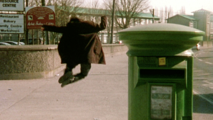

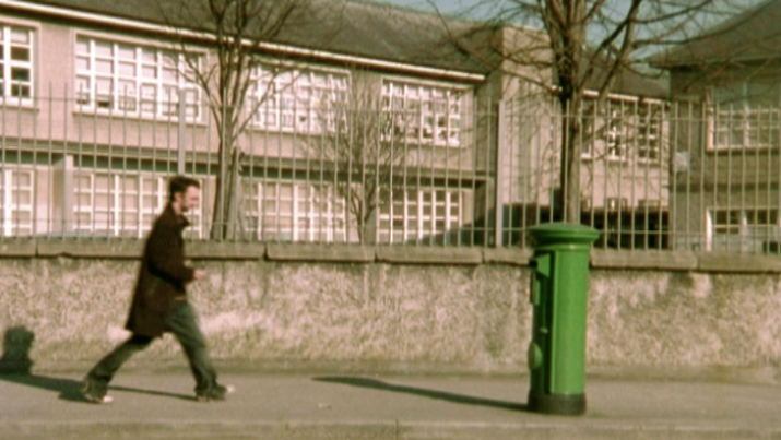

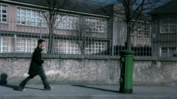

Two shots in a short film I shot on 16mm came back from the lab looking a little rough to say the least
http://www.dvinfo.net/forum/attachme...1&d=1281624185
I've managed to colour correct it a bit using the standard 3 way tool in Final Cut Pro. They still doesn't quite look right to me though.
Can anyone advise me as to how to get it looking better?
I don't know any colourists or editors locally so I haven't been able to get any help.

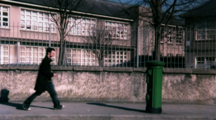

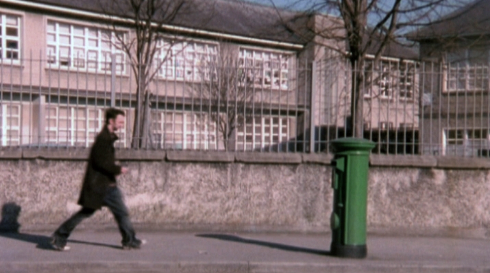

Ok, here's my first go at it... I actually did this before I read your instructions so just take it for what it is...
Help colour correcting a few shots-head-wrecker_out_1.jpg   Help colour correcting a few shots-head-wrecker-2_out_2.jpg

Here's a more neutral take on it.

Perrone's rebuild is nearly spot-on. Unless you spend big bucks with an industry-specialized colorist - and I mean big bucks - you'll never totally get rid of that magenta cast or the slightly washy skin tones.
Unless this is a color-critical project and you've got money to burn I'd take Perrone's fix and run with it.
Personally I like this strange off-color shift; it gives the piece it's own "look", just as many Hollywood productions have.

Well,
I only spent about 15 minutes on it and didn't bring it into my calibrated system, but I thought it was pretty good. Nothing was clipped so I could remove the color cast completely (and did playing around), but honestly, it looked richer with a bit of red in there. I could take it out, but it would make the scene rather bleak, and the skin quite pale.
This is the kind of work I do all the time, but generally not for free because it's rather painstaking. I painted in the sky a bit on this shot, and added a bit of shadow detail. I also darkened the right side of the frame just a touch to give some life to the shot. I tweaked the blacks a bit, but took care not to crush anything since this was supposed to be neutral. I had to go get some reference images of Irish letterboxes to get the green right. Cleaning up an entire film could take a month or more to do right. I've got a short to do that is going to require even more work, and I've quoted 2-2.5 months for that job since some of it will require digitally painting every single scene. Things like taking out walls and staircases.
Old August 12th, 2010, 08:35 PM   #9
Location: Tallahassee, FL
Posts: 4,100
Ok, here we go...
What I did:
1. Lift/Gamma/Gain - Use RGB parade and balance the image for luma and color, lift first, then gain, finally gamma.
2. Use Warm/Cool to adjust overall hues
3. Add slight shadows to top and right of frame to add some richness
4. Add a touch of vignette to draw attention to make subject
6. Drop saturation to 81% to get color of the mailbox right, and skin tone more correct
7. Add specialized black diffusion to remove some of the grain.
If I planned to spend more time on this, I'd fix the sky, and I'd cheat the skin tones with a mask. But in a shot like this, that could take half an hour. And as Robert Lane said, you're getting into REAL money for that kind of work.
Even working at indie prices, doing this level of work with footage that needs this much correction could cost from hundreds to thousands of dollars. If you took it to a someone working on a DaVinci or a Baselight or a Pablo, well, your pockets better be deeeeep.

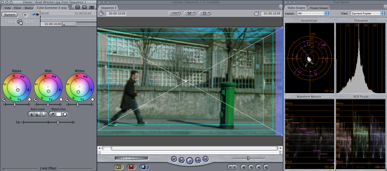

Here's the FCP representation of the first bit of Perrone's process, just a simple 3-way color correction... I pushed the saturation up just a smidge and pulled the mids just a little farther into the green (away from the magenta commented upon earlier)... the rest was done using the eyedroppers for each luma range... black on the shadow under the arm, brights on a window and the mids on a darker bit of stone.
No other alterations.
That's very good! The only thing I don't like (and I saw it in my images as well, is a shift toward cyan in the sky which is why I had to go back and fix it on it's own. Interesting that you chose to push saturation where I pulled mine back. But I see that you pulled your red channel down more in the highs and the gamma which accounts for the difference I think.
Lot's of ways to approach this problem, and good on you for attempting it and sharing it.

My main intent was to show the FCP interface for the effect you've produced... I figured the eyedroppers would get me pretty close to what you're doing and I could tweak from there.
A couple more plain correctors would allow for targeting of the sky, the green thingy and the flesh tones to correct separately based on chroma without having to do much masking.
I'd still vignette at the end to focus the eye like you did though... "Power Windows" have become my new best friend :)

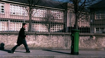

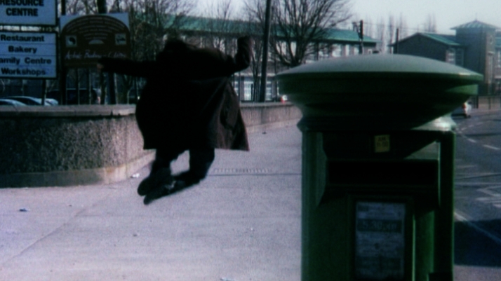

Cheers lads, used as much of the above advice as I could.
Here's where I'm at now. A slight improvement but my limited knowledge of the tools in FCP are letting me down a bit.
Richard Lacey is offline   Reply With Quote
Old August 15th, 2010, 10:31 AM   #15
Posts: 1,675
Play with them, push them to their extremes to see what they do :) It's non-destructive editing!
