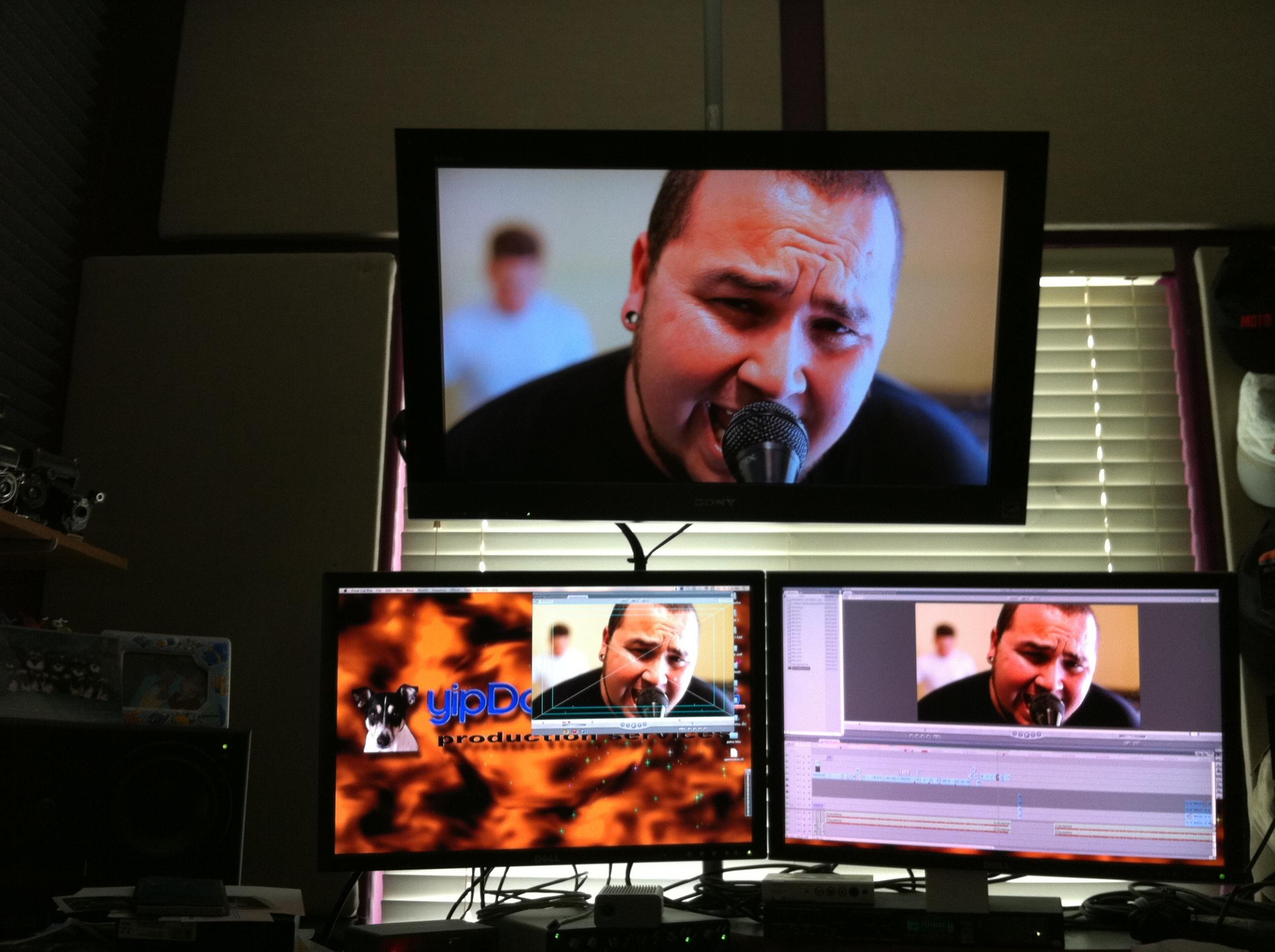

I use a pair of 24" Dells and a Sony 32" Bravia fed from a Matrox MX02 mini with Max.
After years of trying out different configurations, this is by far the best rig I've used for editing and color grading.
The main thing I love about two computer monitors is being able to lay out all the necessary tools in FCP. Also, I tend to use a bunch of apps at the same time...FCP, Motion, After Effects, Photoshop as well as Mail and sometimes Safari. Just love having everything at my fingertips. In AE, it's really useful when I get a ton of layers going. Same in FCP and Motion. I don't have to search around for stuff...it's all there.
So ergonomics is the simple answer!
Having the Sony for watching "reality" is fantastic. Much better than tying up a full computer monitor for viewing. Plus the Matrox allows very easy calibration so I know what I'm looking at is right. (always verified with scopes though!)
The other cool thing is the Matrox auto scales so if I work in 720 or 1080, it show up full screen on the Sony.
Here's the setup...

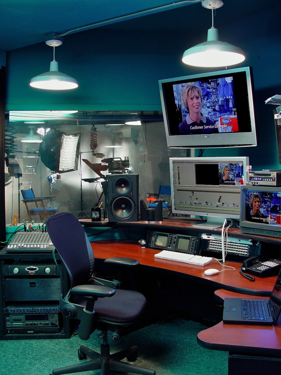

I had two monitors side by side in my studio setup before this one.
Never really got used to the break between them and having to skip over the bezels in the center.
Today, I have a Sony 32 HDTV hung above a large Apple Cinema Display - with a broadcast monitor to the right.
I find this is best for me since the geometry of screen to my eyes distance lets me pan and scan the editing monitor with little if any head motion - and a simple look right for CRT review or a glance up for Home flat screen HD view. This keeps long edit session muscle fatigue to a minimum.
I personally much prefer having a continuous field of pixels ahead - rather than a wider display with a chunk of metal "dead space" between them. But it's a personal thing.
You can get "used" to each. I like it this way.
See photo.

Bill... what desk is that? I LIKE IT!
Old August 22nd, 2010, 05:05 PM   #7
Posts: 1,538
Robert,
Edit System series from Middle Atlantic Products.
Not cheap - but purpose built for video editing and similar tasks.

Old August 22nd, 2010, 06:10 PM   #8
Join Date: Oct 2009
Location: Mesa, AZ
Posts: 1,389
Thanks! It's not that expensive. I will be building a dedicated space in a few months and I want a new desk. An aeron chair is already on the budget sheet!
