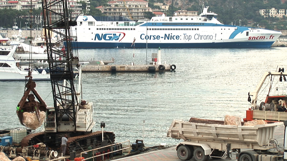

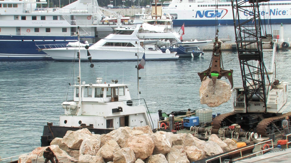

Completely understand if no-one can be bothered with this but I'm struggling to match the following shots from two different cameras (Z1 and A1 respectively). The form a continuity edit so the change is particularly jarring and it's not just the colour but the camera sharpness too so if anyone has knowledge to pass on of matching these 2 cameras or these specific shots I'd be grateful - I have played with the 3-way colour corrector with minor improvement on these shots:

Unfortunately, it is not the cameras as much as it is the time of day/lighting. I don't think you can get these to match up with the 3 way CC, but you can get them a bit closer by bringing the blacks down (darker) & whites up on the right clip and pulling out a bit of the blue & cyan, and bringing the whites down and the blacks up (lighter) a bit in the clip on the left. Evening out the contrasts should help to bring your "sharpness" more in line also.
Since your foreground (subject?) is lit also in opposition, - a bit darker in the lighter clip & a bit lighter in the darker clip, You might be able to balance this a bit by applying the 3 Way CC filter again and with the limit effect at the bottom of the CC filter, select the warm tones of the rocks and brighten them up just a bit.
I didn't want to open up FC to play around with these, but I opened them in PS & made the above adjustments, & though it wasn't a complete fix, it did help a lot.
If your not familiar with the limit effect, let me know.

Thanks for the advice Chris. I had a go at what you suggested which prompted me me into a deeper exploration of the 3-way CC and using the limit effect to match specific colours - the blues and whites of the boats, hue of the rocks etc. The water remains problematic as the first shot is a bit overexposed and the general fuzziness of the Z1 compared to the A1 seems insurmountable but all in all it now looks a lot better and good enough - close enough for jazz as they say!
