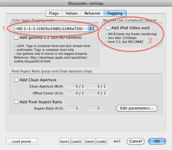

To specifically solve the gamma problem when using x264 all you do is choose the gamma profile of HD 1-1-1.

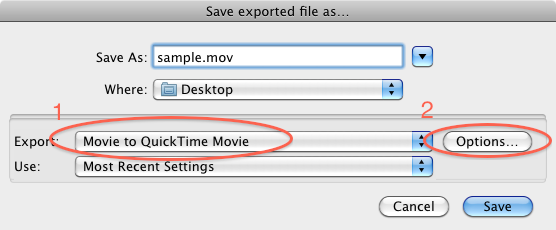

I found this encoder really confusing at first but it works well with default settings. I'm not sure if it can be set up as a Compressor profile but I have used it with success by exporting my FCP project as "QuickTime Movie..." with "Current Settings" and "save as reference movie" checked. Then open it with Quicktime 7 and export it starting here:
http://www.dvinfo.net/forum/attachme...1&d=1283670484
1. Choose Movie to QuickTime Movie 2. Click Options

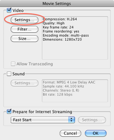

Click on Settings
http://www.dvinfo.net/forum/attachme...1&d=1283671265

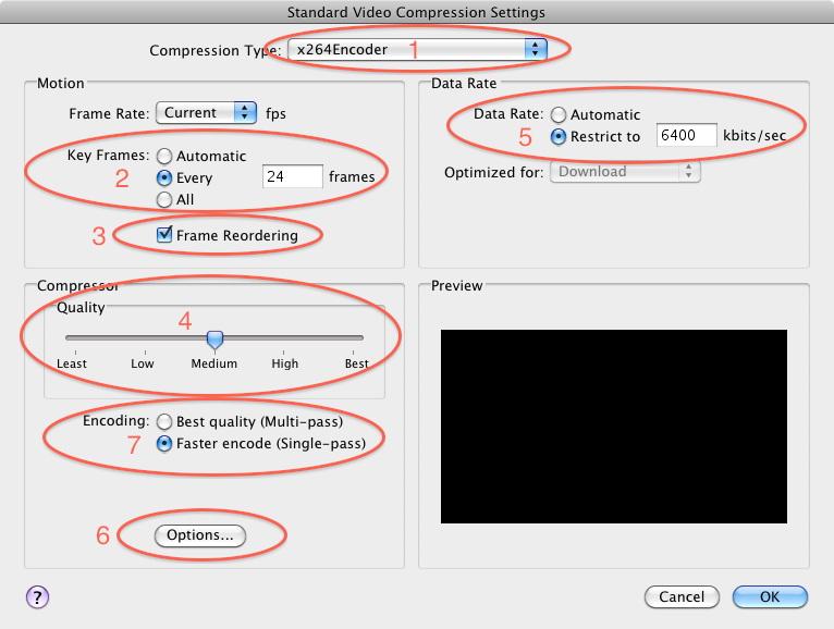

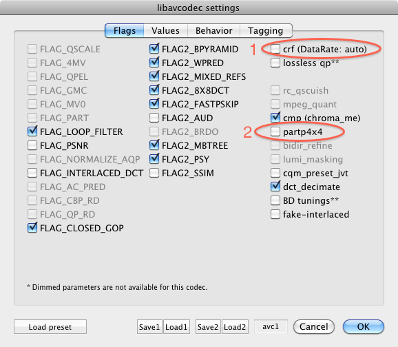

1. Choose x264 2. Choose appropriate Key Frame that you learned by reading the recommended tutorials. 3. Choose Frame Reordering to enable B-frames (also learned in tutorials). 4. Quality here will be over-riden by the choices made in Options 6. 5. Set data rate (read tutorials). 6. To move on to x264 settings. 7. Developer suggests "Faster encode" is not only faster, but may yield better outcome by checking "crf (DataRate: auto)" in x264 settings Flags, or experiment with "Best quality" but be warned about large file sizes.

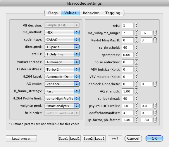

http://www.dvinfo.net/forum/attachme...1&d=1283672203
1. Check, only if you chose "Faster encode" in the previous dialogue. 2. For increased detail (learned in tutorials)

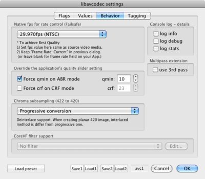

http://www.dvinfo.net/forum/attachme...1&d=1283672792
Just use default unless you learned a lot about keyframe intervals from the tutorials and want to experiment.
Leave it.
1. Fix the gamma issue. 2. Check only if you are making just for iPhone (read those tutorials).

Deep colours in FCP, washed out after export-movie-qtm.png   Deep colours in FCP, washed out after export-movie-settings.png
Deep colours in FCP, washed out after export-compression-settings.png   Deep colours in FCP, washed out after export-flags.png
Deep colours in FCP, washed out after export-values.png   Deep colours in FCP, washed out after export-behaviour.png
