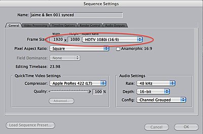

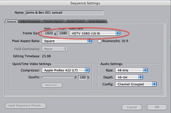

Can't Find Settings Answer for 60D

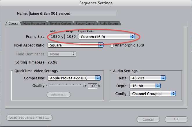

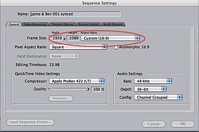

OK, if this is somewhere easy to find, please direct me, I can't find this answer. What settings in FCP 7 do I use for 1920x1080 24p? I'm confused because there's an option that says "HDTV 1080i (16:9), but I DON'T WANT the "i" for interlaced, right? I want a "p" for progressive. Do I set it to "custom" for frame size then?
Note that this is the option for "Frame Size" not editing timebase or field dominance. "HDTV 1080i (16x9)" is a standard frame size. 1920 lines by 1080 columns, that's it.
So you have the correct Frame Size setting, just make sure that the editing timebase is 23.98, the field dominance is none, and the pixels are square (which is exactly what you have) and you're good to go.
