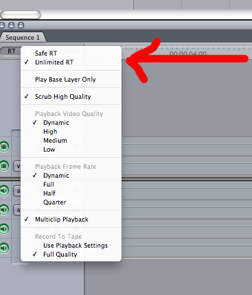

You don't see this?
Normally, it's on Safe RT on default. Changing it to Unlimited RT makes a huge difference in playback of effects without rendering. I put all the rest on dynamic.

Nope. This is what mine looks like.
