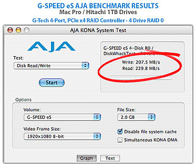

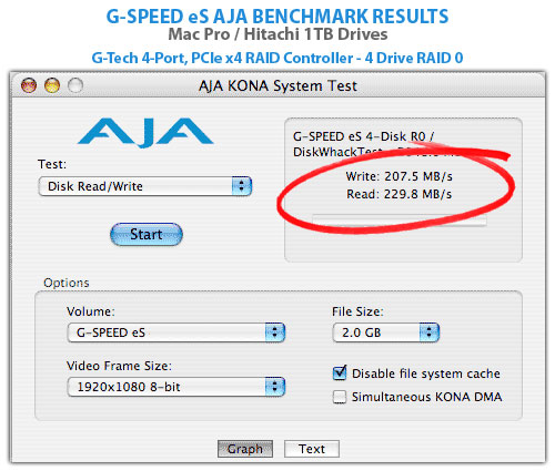

Robert, there is no disk bottleneck. The G-Speed es 4TB with G-Tech raid controller is performing pretty much to what G-Tech claim as per this screenshot from Aja benchmark on their website with Write 207.5MB/s Read 229.8MB/s for a four member RAID-0 array
Mark's problem is that he sees no increased performance even though he is using this RAID array & the reason for that as I explained in my previous reply is that he did not have a disk bottleneck in the first place. As others have noted with more complex multicam projects he should see performance gains.
