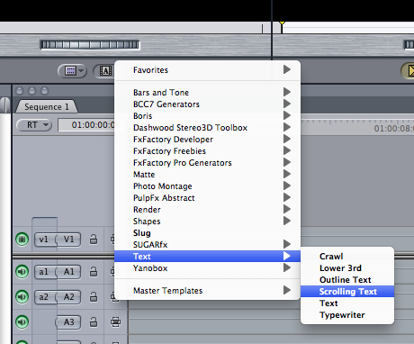

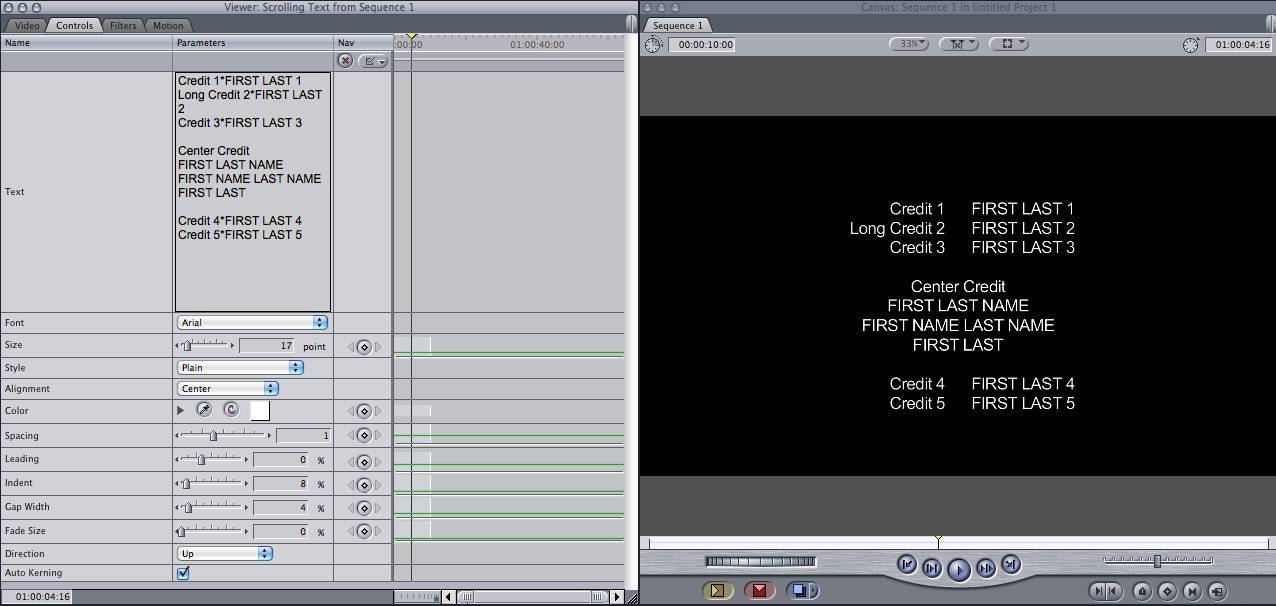

Re: End Credit Formatting
This is extremely easy to do within FCP using the Scrolling Text generator.
Just put a "*" between the credit and the name to create the gutter gap. You can adjust the gap width with the controls in Scrolling Text.
End Credit Formatting-scrolling-text.png   End Credit Formatting-scrolling-text-format.png
Whoa, thanks Tim! I had no idea about using "*" for the gutter gap.
