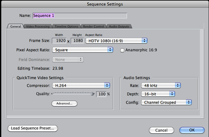

It strikes me that maybe you are looking at the clip properties. You want to look at the sequence properties. Click the timeline and press command-0
See the attached for an example from a 5DM2.
first time w/7d footage-i'm a little lost!-screen-shot-2011-11-10-6.51.51-am.png

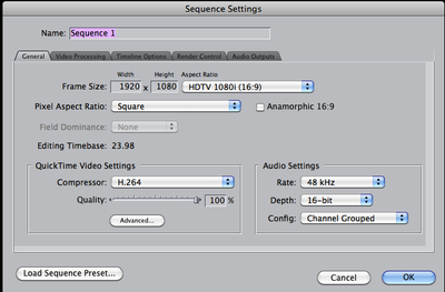

les-
i did exactly what you suggested from the timeline (command+0) and got the sequence properties.
the sequence properties were exactly the same as your attached thumbnail.
the sequence is
frame size: hdtv 1080i (16x9)
pixel aspect ratio: square
editing timebase: 23.98
quicktime video settings/compressor h.264
so where do i go from here?
how do i transcode this material into an form that lends itself to editing?
