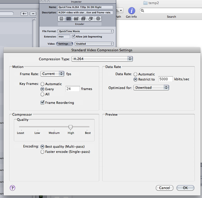

@Austin, keep up the learning. Compressor is a very useful tool and not hard to learn. When you duplicate an existing compression preset from Apple, there's an Inspector window where you can adjust to be what you want. Clicking on the second tab of the Inspector lets you access the audio and video compression settings. CLick on the button for video and you can set the data rate. (see attached)
That is the number you can adjust to make files smaller and bigger at the sacrifice of image quality. While 5000kbps is the recommendation for HD, if it's just a rough draft, I will sometimes use 2500kbps. Notice also, you can also choose between a fast and slow algorithm. That won't affect the file size but rather, the time it takes for the job. Of course, faster won;t be quite as good as slow/ But you may not see the difference.
