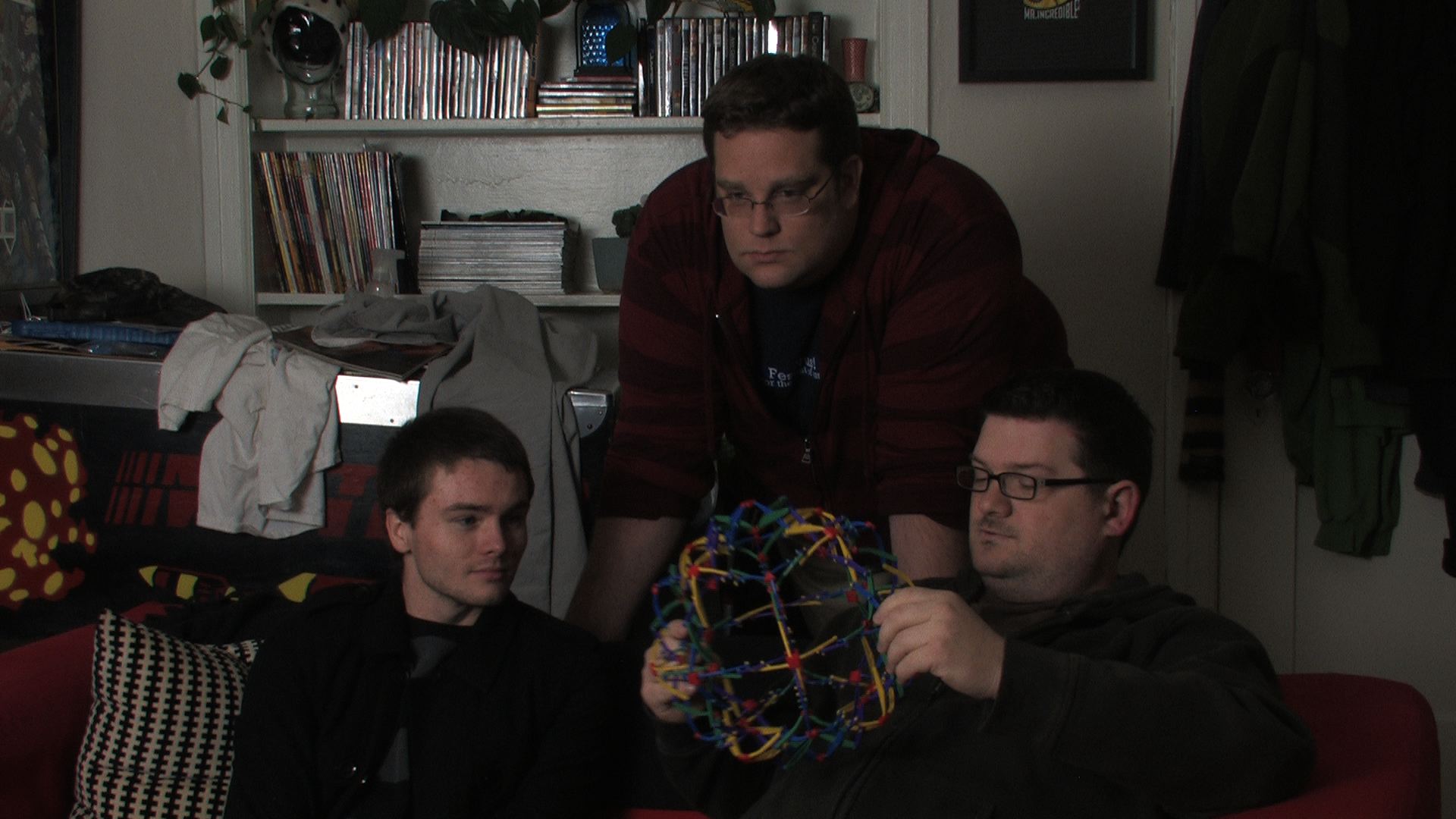

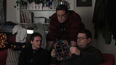

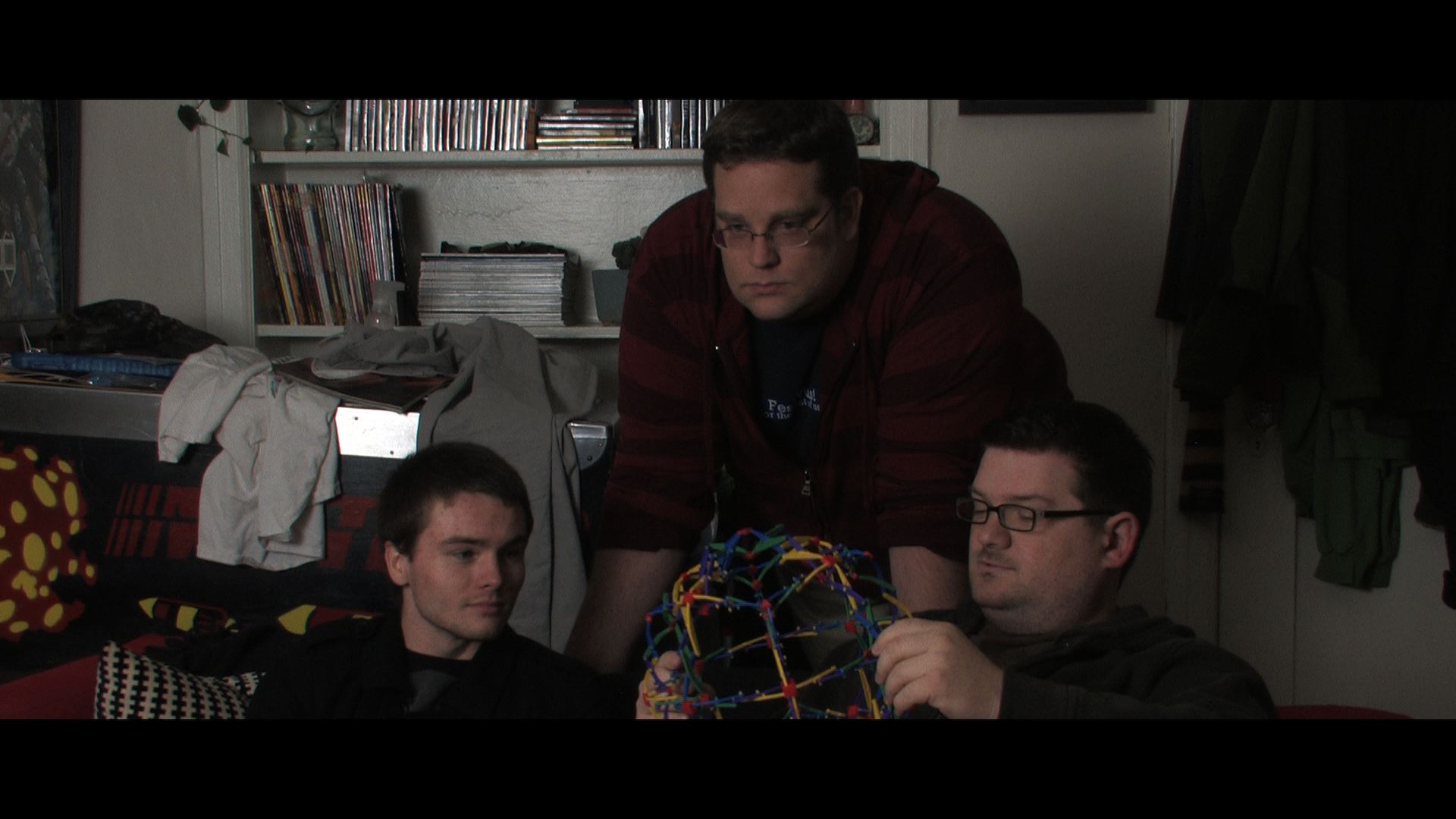

Hey guys, I'm sorry i was so unclear. I'm not starting with dv material. I'm starting with 1920x1080 footage. but I'm trying to crop it even more. Here are two examples guysfull is 6.66:1 and guyswide is 2.35:1. My original problem is in my original post (first post). thanks again for taking the time to look.
widescreen problems in FCP 7-guysfull.jpg   widescreen problems in FCP 7-guyswide.jpg

If you want to create the look of an even widerscreen format than you shot, do your entire edit, then lay a mask over the final timeline. Create the mask yourself, to whatever dimensions you want. Place the mask on the timeline on a track on top of everything else. If there are shots that need to be 'recentred' as a consequence, use the Motion dialogue or the 'image+wireframe' on the problematic shots.
If you need to see the mask lines during the editing process, just enable the track that has the mask.
This assumes you don't really want to crop -- what I'm suggesting is a letterbox mask over the 1080 dimension. But if you do in fact want to crop, I'd still follow the same process I've outlined, then crop in the output phase. Presumably you have already sorted out the dimensions of your export, and the format, as they won't work in traditional Blu-Ray discs, for instance -- so if you want to crop out the mask you've applied, just use the appropriate commands in Compressor -- the preview function will show you if you are cropping enough to eliminate your mask.
