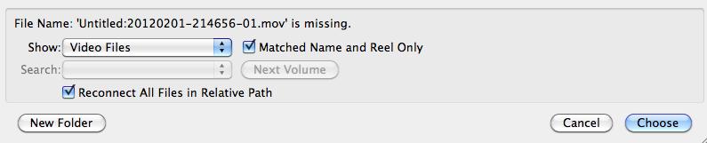

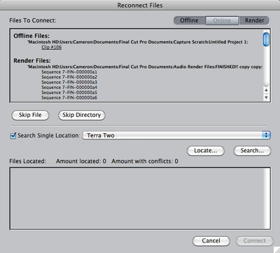

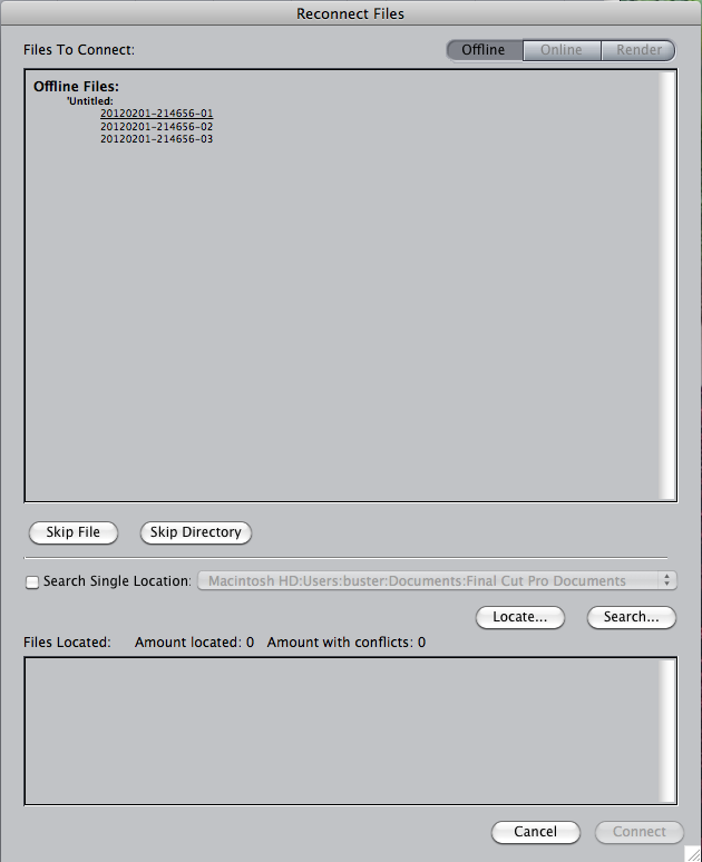

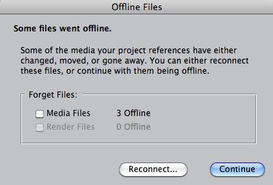

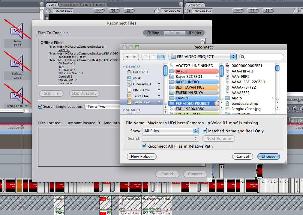

When I open a project with disconnected files, I get the prompt in attachment #1. Clicking on Reconnect gives me attachment #2. If clicking on Search does not find the file, clicking on Locate lets you manually select the file with a file selection window that has an FCP section added at the bottom as in attachment #3. Sometimes, I have to uncheck the checkbox or fiddle with the other controls to force it to take the file I want. You need only do this for each unique directory as FCP will reconnect all the files in it's list of unconnected files as long as the Reconnect All Files checkbox is checked.

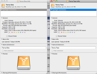

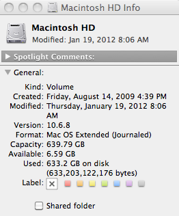

It's a stretch that it's a disk issue. Select the hard disk icon and do command-i to show the Get Info window as shown in the attachment.
Old February 10th, 2012, 05:52 AM   #7
Join Date: Nov 2010
Location: London
Posts: 212
Re: Should I be able to reconnect media from an external HD?
Format: Mac OS Extended (Journaled) - Whatever that means.

That's sort of good news and bad. I just tried to locate each file separately, but it has all the files located already I'm just unable to use the 'connect' button, they are all listed. If I need to get them back separately I don't know how to do it, or even if that is what I need to be doing.

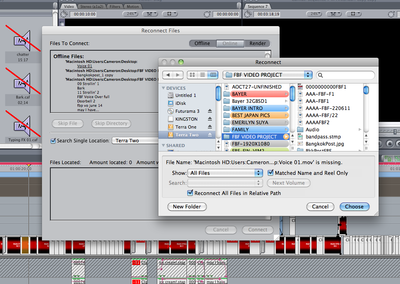

Here's what I'm looking at.

ANd if you uncheck "Matched Name and Reel" then select the file Voice...", then click Choose, does Voice... show up in the bottom half of the grey window?

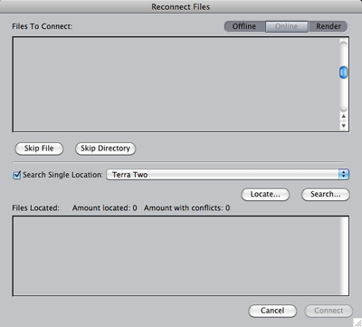

I tried to locate the 'voice' file but it's the only one not there and it must have been one I deleted that I didn't need anyway.

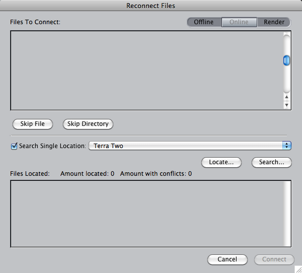

I have tried locating other files separately by going to 'Reconnect Media' but again, i'll see stuff listed in the grey window but nothing results in the connect button turning blue.

Well you can do without the render files... those can be regenerated from the timeline but you do need the original Clip #106 file. I wonder if the # character is causing a glitch.
