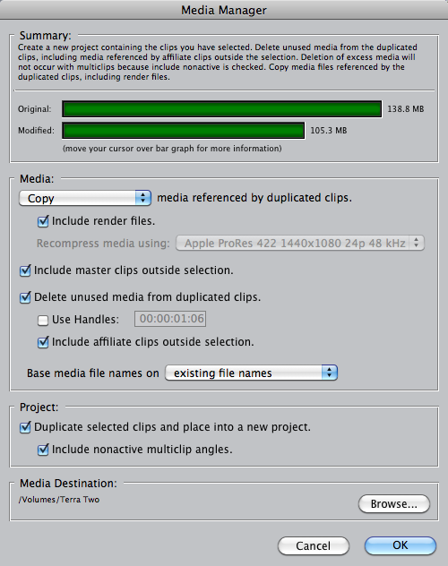

I use the media manager.
Select the main timeline in the browser and go to Media Manager.
Copy to new project and save on the external drive.
Pros - it gathers all assets from various locations and puts them in one place.
Cons - you can't select multiple timelines (pretty sure) and anything unused in the timeline is not copied (this is mostly good, but can be a problem if you need something later that you forgot about).
Various options are available. You can choose to include media outside the in/out points or add a predetermined handle size (i usually use 3 second handles). Don't use 'move' - i've heard of unreliable results with this.

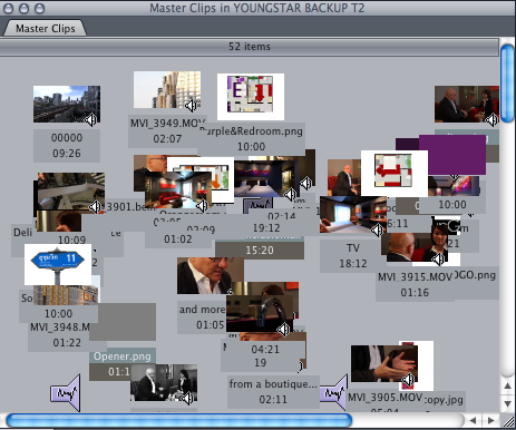

Backup Test
I tried backing up my last project (which is still on my laptop) using the Media Manager and it seemed to go very well. I was surprised at how quickly it took and it looks like it has only copied the files that were used in the project thus saving a lot of space by ignoring everything that wasn't used, and all the files are in one place, albeit rather messily (see pic) - I was going to ask how to auto tidy the files window but a more serious issue arose when I tried to backup my current project which I will come to in the next post.
The first backup appears in the menu on my terrabyte with the render files in a separate file. I guess I will only know for sure if the backup has worked when I delete the project from my laptop to free up space.

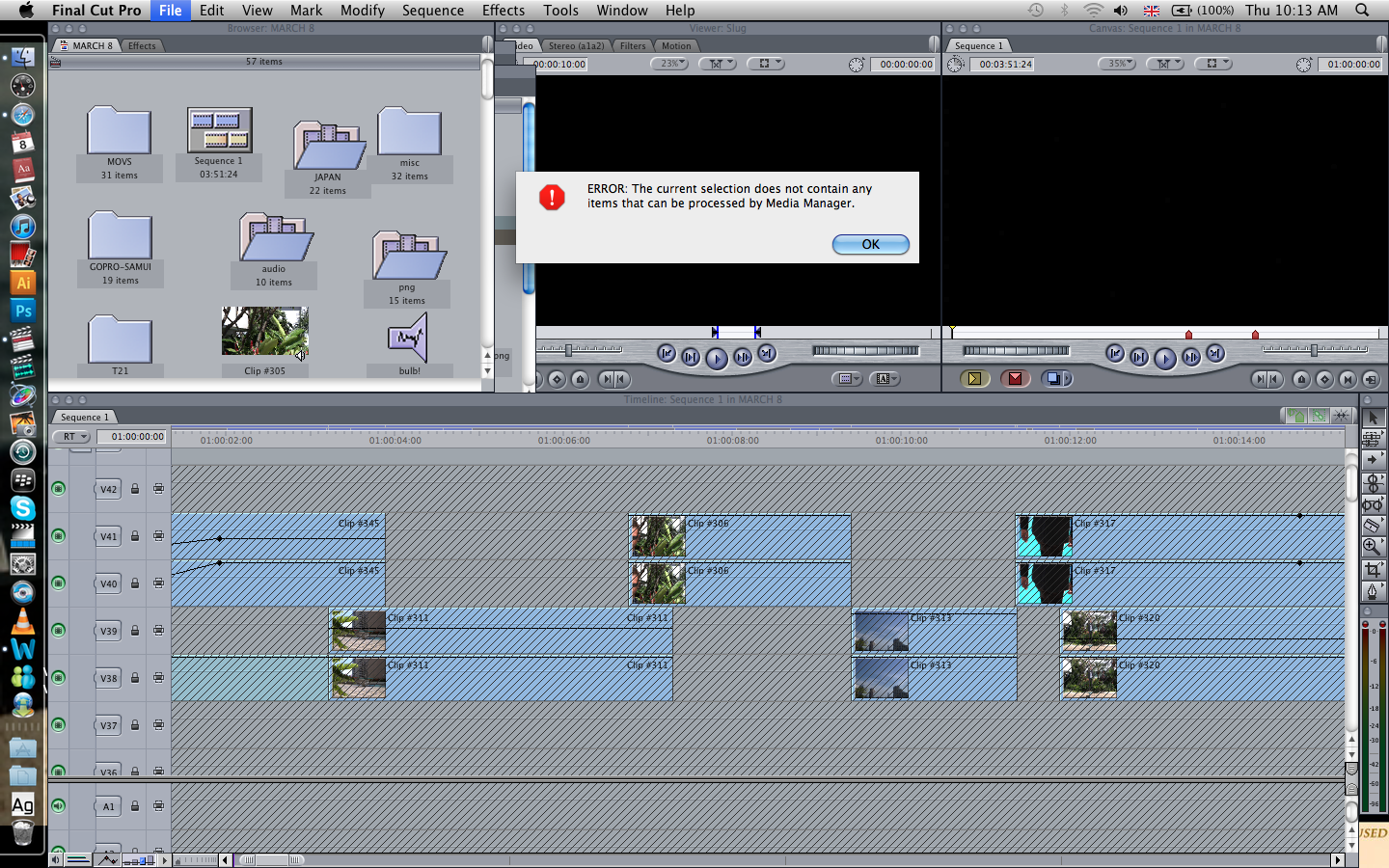

2nd backup failure
This is deeply concerning as I have been working on this current 3 minute project for about 8 months.
As soon as I clicked on the media manager, this is what I got.
I need to backup this project asap and this is considerably worrying.

Did you select the 3 minute timeline/sequence before engaging Media Manager?
This sets the focus of what you want to 'manage.'
Mark Ahrens
www.heritagefilms.net
Mark Ahrens is offline   Reply With Quote
Old March 9th, 2012, 06:30 AM   #11
Join Date: Nov 2010
Location: London
Posts: 212
Re: How do you backup to ext HD after completing a project?
No I forgot, and you told me to do that in the first reply.
It's now working and I have egg on my face, apologies for missing that before.
Thanks for putting me back on track.
