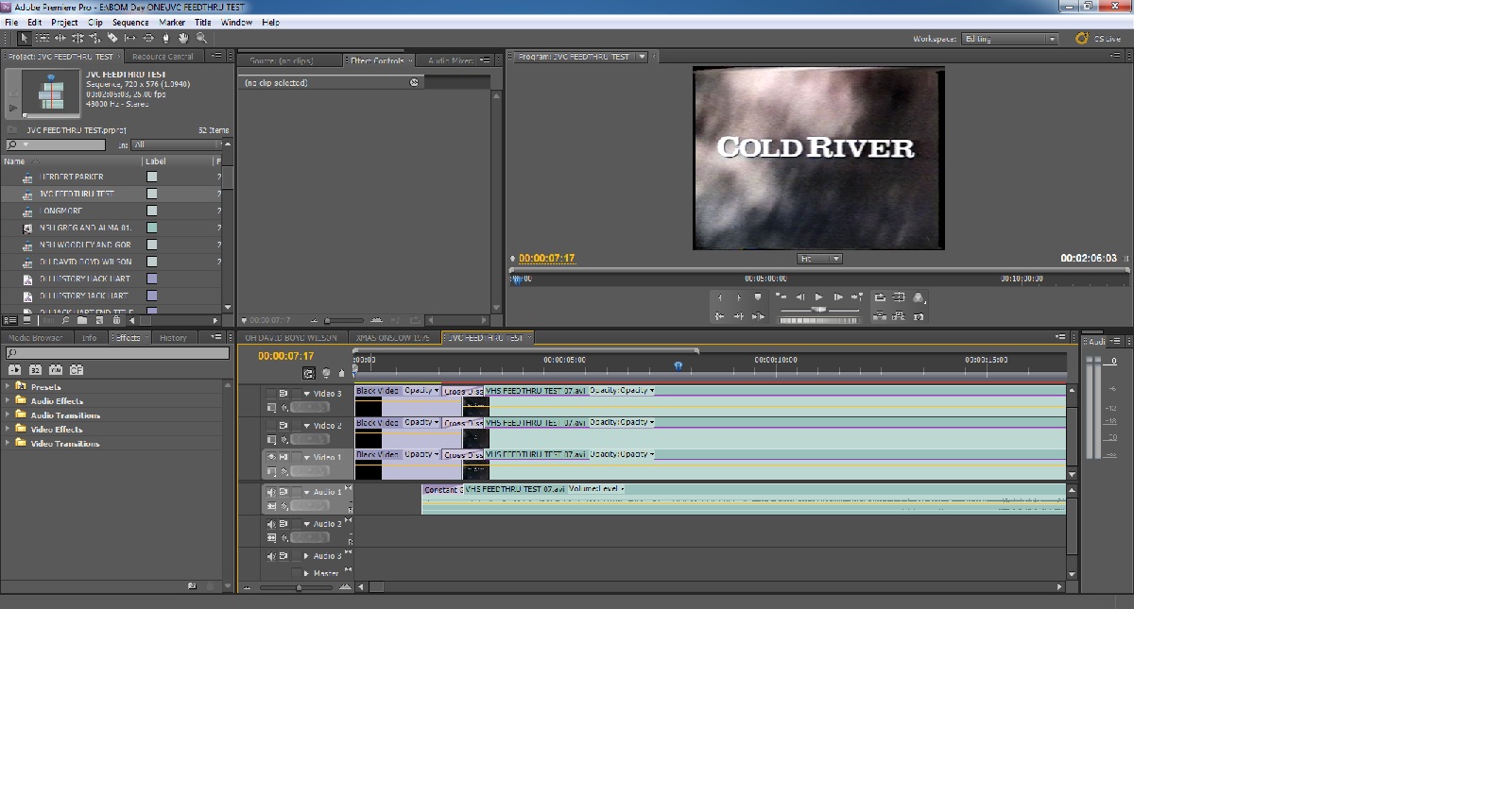

I got hold of someone's copy of a VHS rental film which was well worn. The film "Cold River" may no longer survive as it was not high-end mainstream.
I assemble/edit in Premiere so this may not be a lot of use to you.
As a form of primitive noise reduction I laid three identical clips on the timeline, two delayed sequentially one frame later than the other. The two upper tracks I set at 33% transparency. The idea being that any video noise is hopefully lowered by about a third. The downside is that three times as much noise will be seen and there will be motion trails. It seems to work - sort of. If you try this you may find you have to increase contrast and colour saturation in all clips as they may combione to appear very flat. I did this with the cineform plug-in for levels and colour correction but the simpler brightness, contrast and gamma tools in FCP should do just as well at this level.
By time I made that screen grab, I had trimmed all the clips head and tail to common start and end points.

You may be able to get away with a little sharpening applied to the exported clip after stacking the layers.
Another fake is to import the SD capture into a HD project but not scale to frame size so you end up with a windowed image inside of a thick edged black frame. It is also less obvious that you have masked out any flagging on the upper and lower frame edges.

I was surprised given the quality of the print, but there doesn't actually seem to be any gamma displacement. I'd assumed it was several generations old, which I understood meant there would be some colour movement, but when I zoomed in on a nice brightly coloured object and played with AJW's Y/C Delay filter, it was clear there was no improvement to be had there.
I tried your 3 layers, top 2 at 33%, +1 +2 frames... But indeed found the motion trails annoying... Instead I tried -1 +1... That seemed to give good results with the same premise, but less obvious trailing.
I used TMTS's Smooth and Sharp to sharpen the image, and then a standard FCP colour corrector to lower the whites because of the sharpening... (and also boosted the mids and deepen the blacks)
