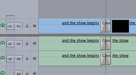

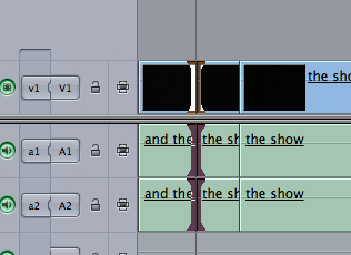

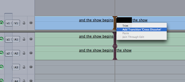

Greg Boston August 10th, 2006 12:18 AM
Originally Posted by Scott Jaco
I just spent an hour looking for settings to allow an automatic audio crossfade w/ cross-dissolves and still no luck. I always edit with that figure 8 icon pressed in the top right corner of the timeline.
The video & audio tracks are linked like they are suppose to be. Funny thing is, when you go to edit a crossfade by moving it or adjusting the legnth, the audio follows it like it should, it just won't create it automatically.
Any help would be appreciated.
In the pictures above, I first used the goto next/prev edit to position the scrubber right on the cut. That's where you see the hour glass icons on the video and audio tracks. Right click to get the menu I show and select the cross dissolve. The result should be the third picture. That's all I did, I promise!
There's got to be something missing cause it works for me. Make sure all the track selects are set like mine at the left of the timeline. If your audio tracks are locked, they won't edit.
-gb-
Scott Jaco August 10th, 2006 02:02 AM
I finally figured it out. THANKS!!
I held the control button on the keyboard while clicking on the edit point and walla! The mini menu popped up and it did the video & audio crossdissolves.
I don't have a right click on my mouse, so I have to hold control down while clicking to get that same menu.
The pictures you included in your last post wouldn't display on my screen for some reason. I just got 3 blank boxes.
Thanks for working with me, this will save me a lot of time.
