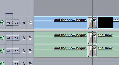

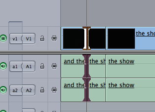

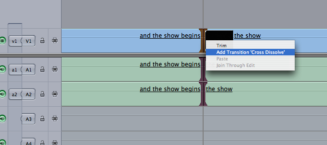

As did I when I made the post. I had audio that came from the on camera mic and was imported with the video. That may make a difference. But when I turned off the linking and added a cross dissolve, no audio transition. Turn linking on, add cross dissolve, and audio crossfades as well. Maybe it's a preference setting somwhere.

In the pictures above, I first used the goto next/prev edit to position the scrubber right on the cut. That's where you see the hour glass icons on the video and audio tracks. Right click to get the menu I show and select the cross dissolve. The result should be the third picture. That's all I did, I promise!
There's got to be something missing cause it works for me. Make sure all the track selects are set like mine at the left of the timeline. If your audio tracks are locked, they won't edit.

I held the control button on the keyboard while clicking on the edit point and walla! The mini menu popped up and it did the video & audio crossdissolves.
I don't have a right click on my mouse, so I have to hold control down while clicking to get that same menu.
The pictures you included in your last post wouldn't display on my screen for some reason. I just got 3 blank boxes.
