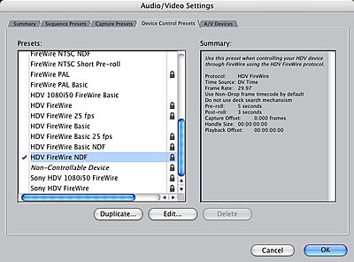

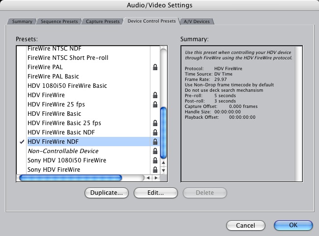

In my Audio/Video Setting I don't see a "HDV FireWire 23.98" in the device preset pull down menu. However the "HDV FireWire NDF" seems to work in the easy setup mode.
Any suggestions?

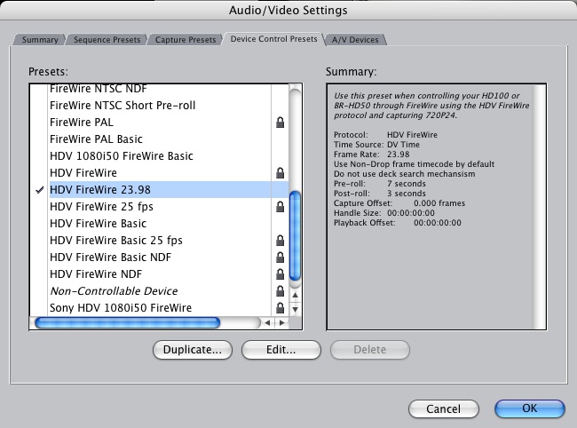

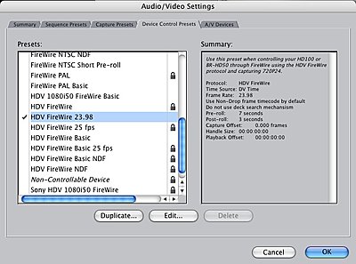

Updated FCPRO and our BR-HD50's today. Once I went into Audio Video settings and corrected the device control preset to read 23.97 TC all is well. I was able to capture 24p just fine. The missing video happens over any pause/rec break on the tape as FCPro seems to think the Mpeg stream needs to be restarted. I didn't try setting preroll to 1 sec to see the effect on these long breaks as it "Searches".
But I did try logging in and out points for the shots one by one. Then setting preroll to 7 seconds to allow the BR-HD50 to get up to speed before the capture. I walked away and 4 or 5 shots captured fine without any missing footage.

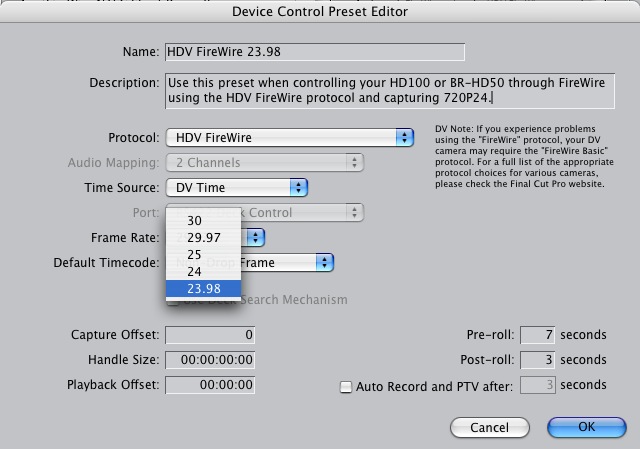

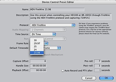

You know, you aren't the first person to mention this. Maybe this preset was already there from when I was doing my own unsuccessful experiments with 24P capture.
Anyway, I will edit my advice in the first post and add more specific instructions here.
  • Open Audio/Video Settings
  • Select the Device Control Presets Tab
  • Select HDV Firewire NDF and click the Duplicate button
  • Change the frame rate to 23.98, the preroll to 7 seconds, and edit the name to read "HDV Firewire 23.98"
  • Either "checkmark" your new setting or confirm it is set in the Summary tab
  • Click OK
