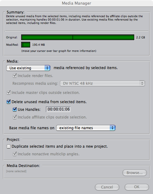

Most folks recommend that you use media manager because it won't screw you up like you can by moving files around yourself.
Betsy, I am with you and I know what you need to do because I have done this already to preserve drive space.
After setting in/out points on your individual clips, select the ones that you know you won't need the extra media from.
Open Media Manager, choose 'use existing' and lower down choose delete unused media. However, for editing purposes, leave handles of 1 or 2 seconds.
You'll get a summary paragraph above and the bar graphs will show you how much space you are going to free up with the operation you are about to perform.
I'm including a screen grab for you that I quickly set up by selecting 5 clips of a project. You can see how little of the clips I am using by the discrepancy in the bar graphs.
When you click OK, you are going to get a stern warning from FCP that you are about to permanently remove the media from your drive and that the operation is not reversible. But the media you're removing is the stuff outside of the in/out points+handles which is what you want to do.
regards,
-gb-
